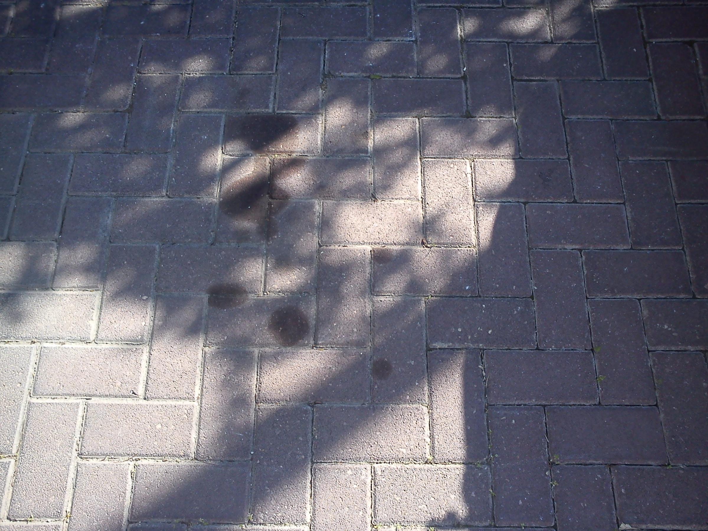

I noticed today where I park the car an area stained by oil on the ground.
Not much, but definitely new.
It is around the area of the car center, not the motor. Maybe the Gear rear side or the area where the Gear Shift lever is.
Before going to the garage (will do so soon if required) , any ideas what may cause those stains and what may be involved in fixing the leak?

Congrat's, I joined the club of leaking gear sleeve.
Here is the pic - taken at the service center.
Also - the pic of the oil stain on the floor - only few days old and growing. So the leak is not too minor and need to be taken care.
