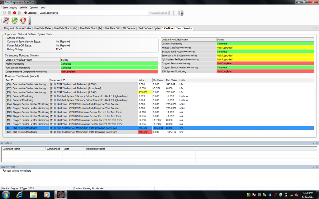

here is what it's showing..
screen shot one taken right after it whent into limp mode
screen shot 2 taken after all codes where cleared and a full system check was performed.
At this point I don't even know where to start..
