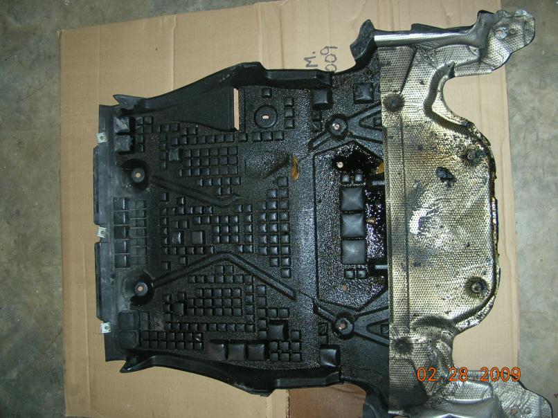

Originally Posted by androulakis
SO far no oil drips, but it's amazing what the belly pan can hide...
Don't I know that...
this is a picture a day after we purchased our S, I was just checking things out and..........
BTW George changing the pan gasket isn't all that difficult, best advise on that is to raise the motor rather than dropping the sub-frame. Also do it when you are doing a routine oil change, why waste the money.
Attached Thumbnails Dual Climate Control Valve (DCCV) Source-jaguar-2-025.jpg
