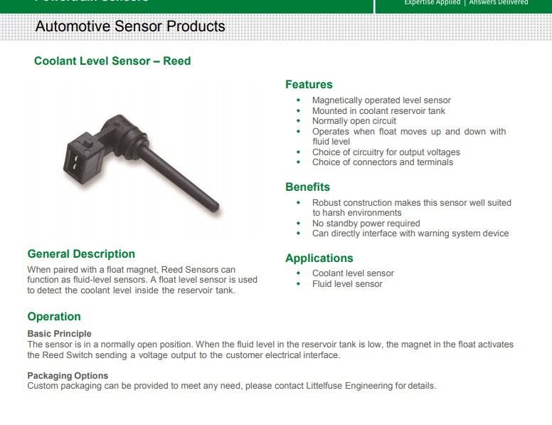

Default Your coolant tank and the "reed switch"
As you'll read, the switch does respond to a floating magnet inside the tank. float is high = no alert. Float is low - dash alert. You should be able to hear it if you shake the tank. RockAuto.com has a great price on a replacement tank and sensor for around $30..
good luck.
Bob
