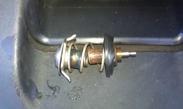

Hi mate, if you've followed the picture on the eBay link I believe you have got the thermostat incorrectly configured in such a way that it can't actually open fully. Image below is the correct arrangement with the 'pin' part fitting in the cast water pipe (the one that comes away when you remove the 3 bolts)
Hope that helps.
Hope that helps.
Ha ha....ya ever had one of those days you feel like you need to go back to school........yep I've got it facing the wrong way.....It just fit perfect so I thought it was good....
Thanks for all the help guys!!!
Old Nov 20, 2012 | 06:10 PM
caldoofy's Avatar
Joined: Jun 2012
Posts: 369
Likes: 224
From: newcastle
Yeah it fits both ways round the I took this photo for reference when I changed mine. That's what these forums are for glad we could all help :-)
