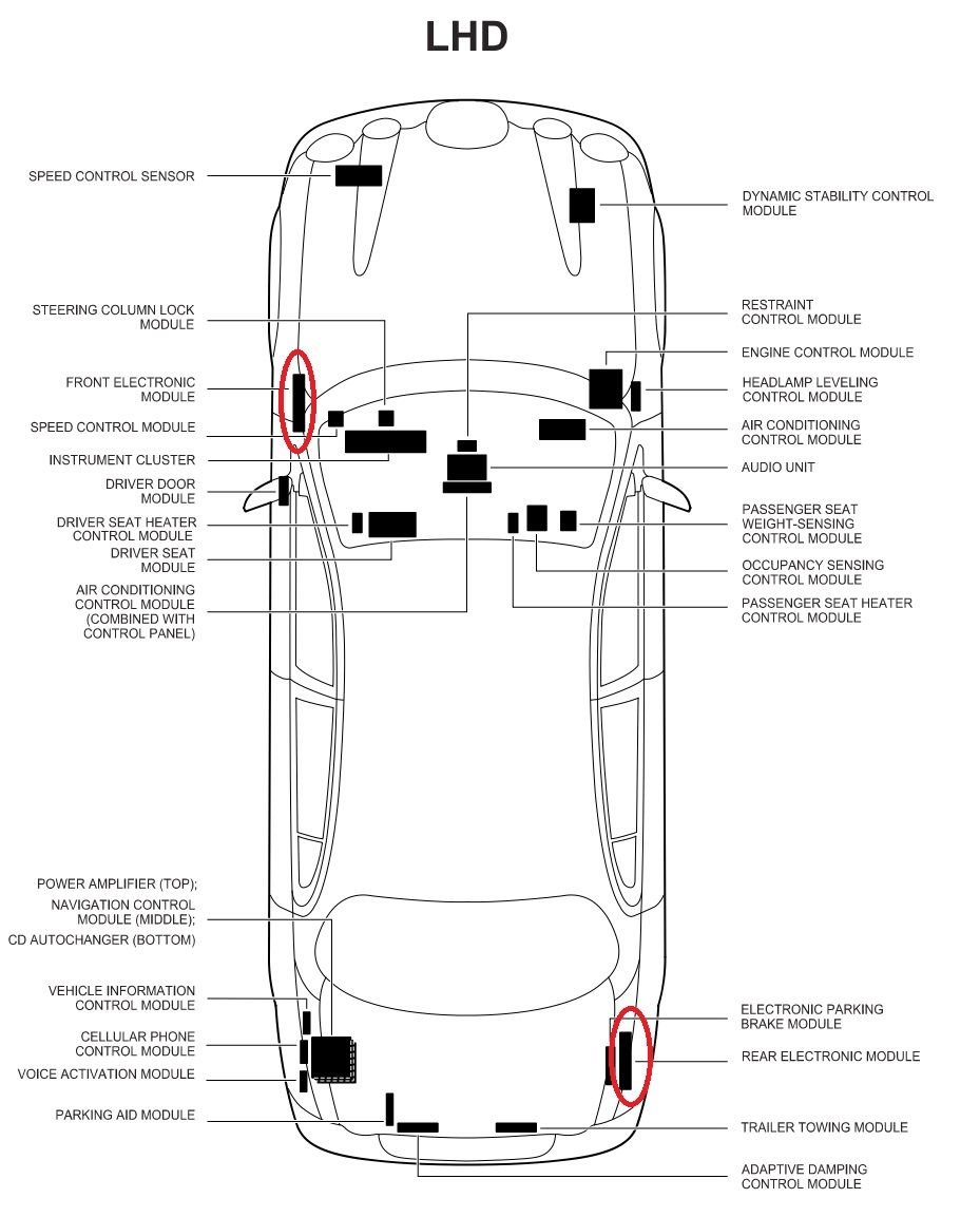

Last edited by clubairth1; Jan 20, 2026 at 11:56 AM. Reason: Forum will not allow pictures!!!!

The OP is in the UK, so vehicle is RHD. Perhaps RHD component placement is a mirror on the opposite side?

Just look at Jag doc e.g. on JagRepair.com - Jaguar Repair Information Resource no need to guess.
