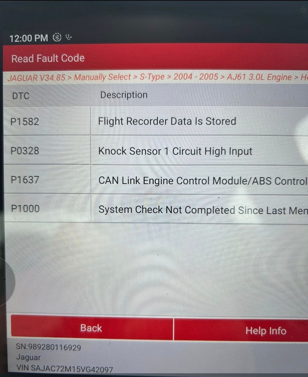

Hi all...wondering can anyone help me here in the group, if you have experience or expertise of this .....my project is replacing my 2005 3.0 V6 Petrol engine which I have done..( and all the ancillary bits that go with it and break off etc in the process!)..Car is up and running again & driving after a no of months .Trying to sort the last few faults if anyone can help me here.My mechanic is good but knows more proper Jag knowledge is probably needed.
Photos are of the code reader faults with replacement engine and 10 mins after we cleared them these popped up ...really appreciate any thoughts insights or guidance..Chris

Check connection to RH knock sensor.
Could be wiring or faulty sensor itself?
ABS module will log C codes. (Chassis codes)
Any Chassis DTCs?
