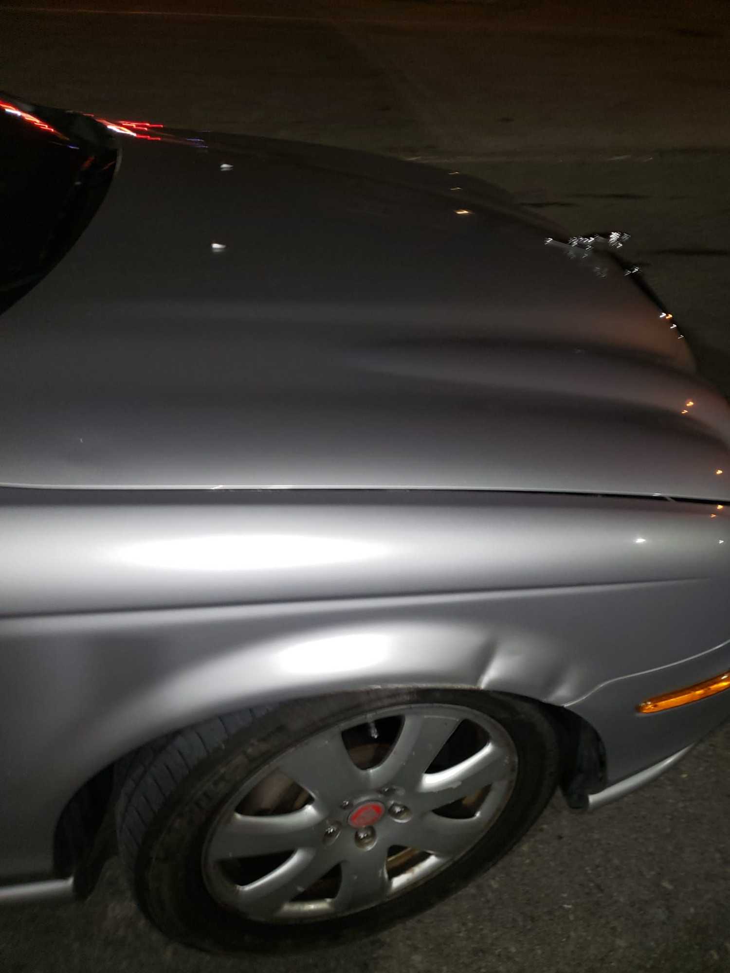

Lady reversed into me today. Was wondering are all 2000-2008 fenders compatible? It's a 03 stype v6 and found a fender at the wreckers for $100
from an 06 str.

Same happened to my wife: Another woman, which was in no condition to drive, reversed - without looking - into the fender of our stationary S-Type on a parking lot.
For all I know, all S-Type fenders are the same, apart from the colour of course.
To swap the fender, the frt. bumper needs to be removed.

Is it difficult to remove the bumper? I'm guessing it doesn't have to be fully dropped but disconnected from the side under the fender.thx for the quick reply

If I recall correctly, removing the frt. bumper only on one side is not really possible, it needs to come off completely. It is not difficult, but a lot of work. All the many little screws have to come off. And the connector to the wiring loom section in the bumper needs to be disconnected, and that is a stubborn connector. I think there was possibly a trick, something like shifting a lever-like thingy to unlock the connector, before you can pull it apart, which would still be hard. WD40 helps. The wheel arch liners have to come off as well (possibly only partially) as it has bolts, which are holding on to the bumper as well.
So if you plan to add DTRL (Day time running light, fog lights with DTRL LED halos), this would be a good time to do it, while the bumper is off anyway.

When I fixed my passenger side front fender I took the bumper all the way off. I had to put the finder off and on several times to get the gaps right. So I think it will be better to just remove the front bumper before stating the repair.
