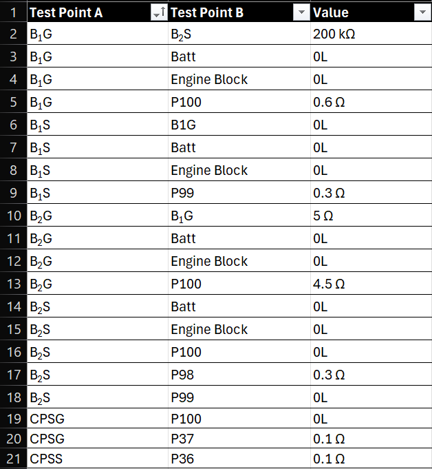

Completed Electrical Checks 2
Additionally, voltage on knock sensor signal (sensor unplugged, ign. on) ~4.5V and I can't recall what/if I found voltage on the ground. I doubt it or I would have been more inclined to put it in my notes.
