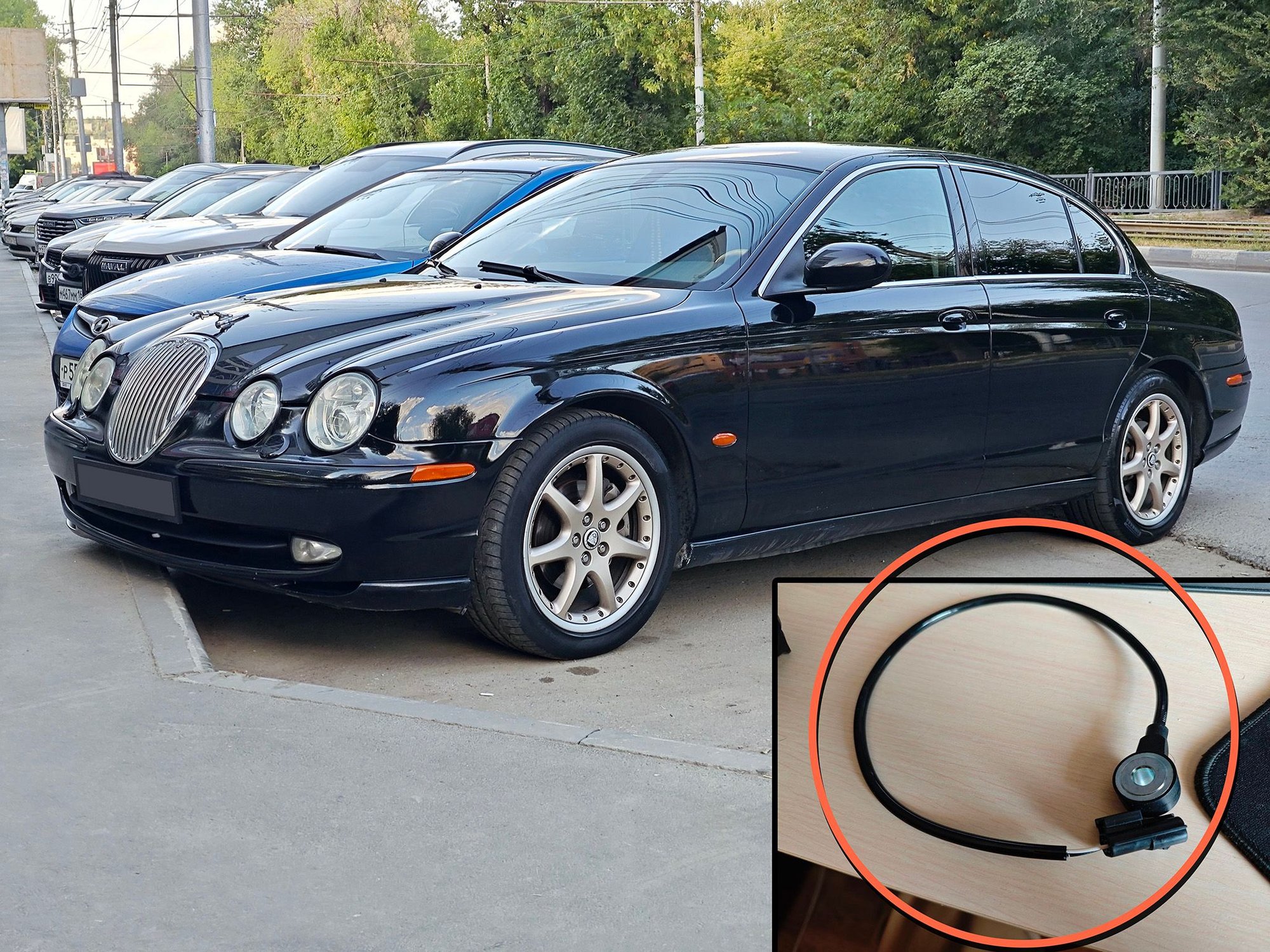

Hi!
I have a persistent issue with my car, and I’ve been struggling with it for over two years. I've done a lot of work trying to bring the car to perfect condition — many things have been fixed or replaced — but this one issue just won’t go away.
The problem:
I’m getting error code P0333, which refers to the knock sensor 2 circuit high input.
When this happens, the car goes into “restricted performance” mode and limits the RPMs to 3000.
When the error occurs
  1. The error always shows up at cold start — if the car has been sitting for several hours. The error goes away after some time, and the duration depends on outside temperature:
    • In cold winter, it may take 30+ minutes;
    • In hot weather, it usually disappears within 10 minutes.
  2. If I’m driving on the highway for more than ~2 hours, the error may come back, and it goes away again if I turn the engine off for some time.
  3. The error sometimes shows up during heavy rain or after driving through water.
  4. Occasionally, it can appear randomly, but that’s rare.
Additional notes:
  • The error can be reset via ELM or Jaguar IDS software, but it comes back after few seconds.
  • The check engine light doesn’t always illuminate when the error appears.
  • If I reset the code with the engine off, it disappears — but comes back within seconds after starting the engine.
  • The code does not appear with just ignition on — only after actual engine start.
What has been done:
  1. Replaced the knock sensor with multiple original and compatible sensors (all tested — signal is correct);
  2. Wiring from the knock sensor to the ECU was checked — everything is fine;
  3. Fuel injectors cleaned;
  4. Engine flushed with oil treatments multiple times (to remove deposits);
  5. Brand new OEM alternator installed;
  6. Engine mounts replaced with new OEM parts;
  7. Tried running 95, 98, and 100 octane fuel — made no difference;
  8. Engine ECU was re-flashed with the latest official firmware — no change;
  9. Spark plugs replaced with correct new ones.
The engine itself runs smooth and clean. There are no signs of knocking or any other error codes.
Electrical systems are working fine. Occasionally, in hot weather, I get a temporary ABS/DSC fault, but it disappears by itself and timing seems unrelated to the knock sensor error
Car: Jaguar S-Type 2003
Engine: 3.0 V6 (AJ30)
I'm extremely grateful for any help, ideas, or advice you may have.
This is literally the last remaining issue with the car — everything else is in great shape.
I’ve already done so much trying to fix it that I’m out of ideas, and I’d really appreciate any suggestions.
Thank you!

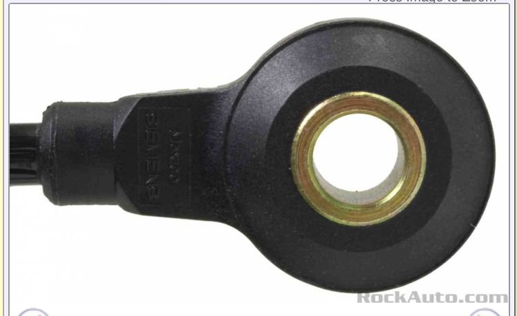

Is the sensor head secured by a single bolt like this example?:
Image shamelessly stolen from RockAuto
If so, my first thought is the bolt could be bottoming out in a blind hole. The bolt would feel tight but is not properly clamping the sensor to the engine. The bolt could be too long, you’ve got debris in the bottom of the blind hole, or the replacement sensor is too thin.
The OBD code list has this as the first possibility:
”Poor sensor contact with the engine block”
JagRepair.com - Jaguar Repair Information Resource
If that’s not it, how about this oddball theory? Could the other knock sensor be confusing the poor computer? No idea how knock is monitored, but maybe the computer compares both sensors. If it sees a big difference, it flags what is deemed the bad sensor. But if the other sensor is sending an inaccurate signal, the poor computer may misinterpret the wrong one as being out of tolerance. If this doesn’t sound too far-fetched, it may be worth gambling on replacing the “good” sensor.

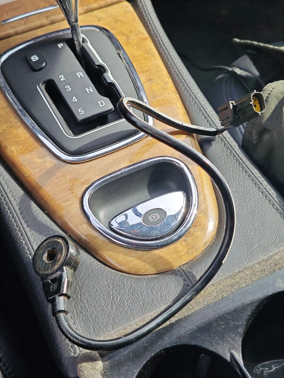

What I can say for sure is that we’ve definitely replaced both sensors and checked the wiring thoroughly. The top sensor (AJ85676) has actually been replaced three times already, each time with the correct torque applied — but it hasn’t made any difference.
