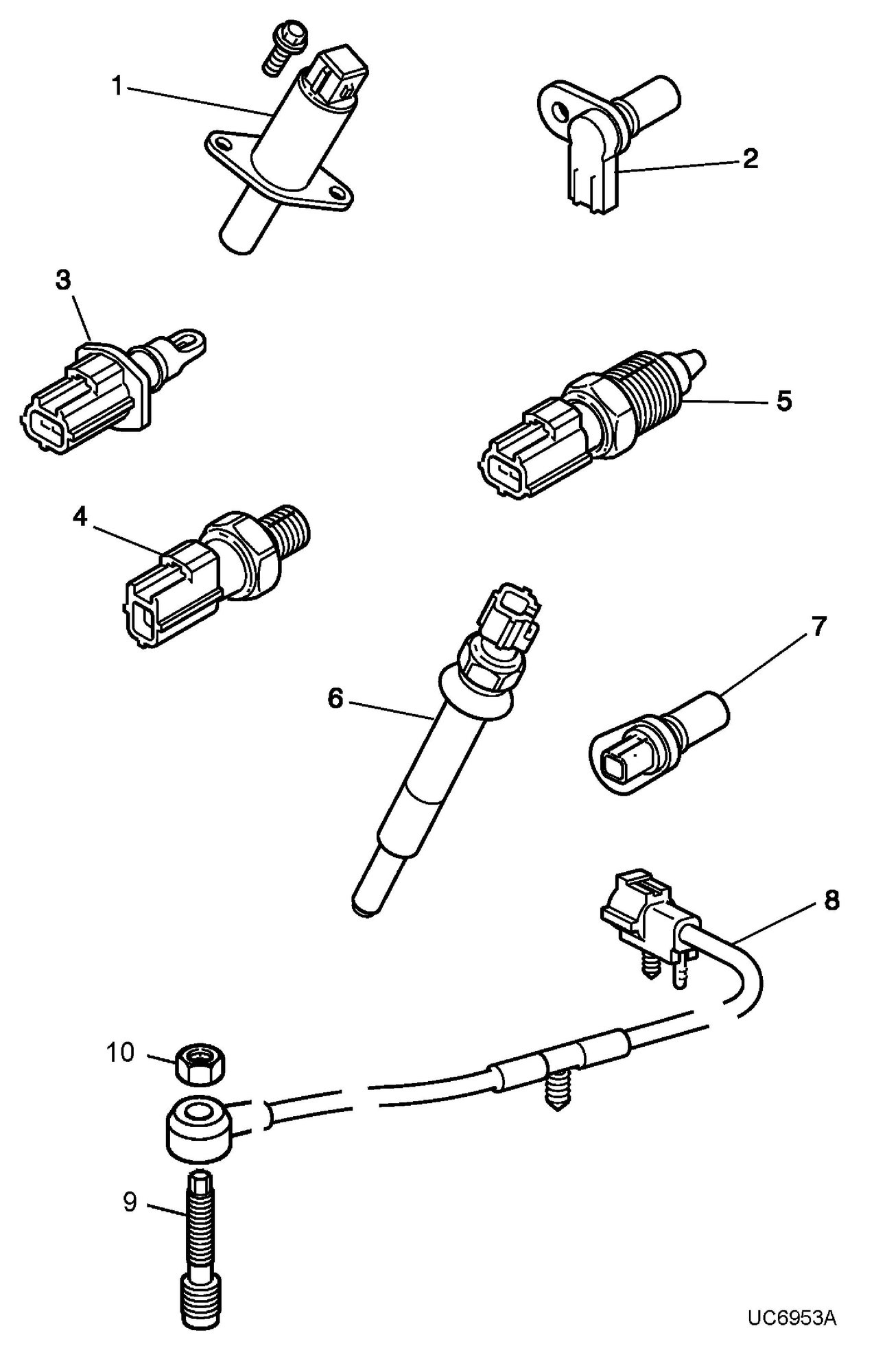

Did you ever figure out which sensor (top in the V, or side above the starter) is responsible for the code? See my previous comments about the confusion for which sensor is #1 or #2. To confirm which is which, I think you could temporarily unplug whichever sensor connector is easier to access, most likely the one on the side. Start the engine and you should get a new code for the sensor being disconnected. If sensor #1 was disconnected, I believe you'd get a new P0327 code. If sensor #2, you'd get P0322. That should at least confirm which sensor is causing trouble.
What about the mounting hardware for the sensor? Is it a bolt or a stud and nut? Take a look here, which shows a stud (9) and nut (10). Poking around online, I see some cars appear to have a bolt. If the stud/nut combination uses a self-locking nut, the torque value may be different than a simple bolt:
https://parts.jaguarlandroverclassic...5/brand/jaguar
Back to the sensor itself, I'm seeing different part numbers for the different locations. Based on the unclear numbering of the sensors, is it possible the wrong one is installed in the troublesome #2 position, whether that is top or side? I do not know the difference between the two sensors. Is the difference internal, or just the length of the harness?
