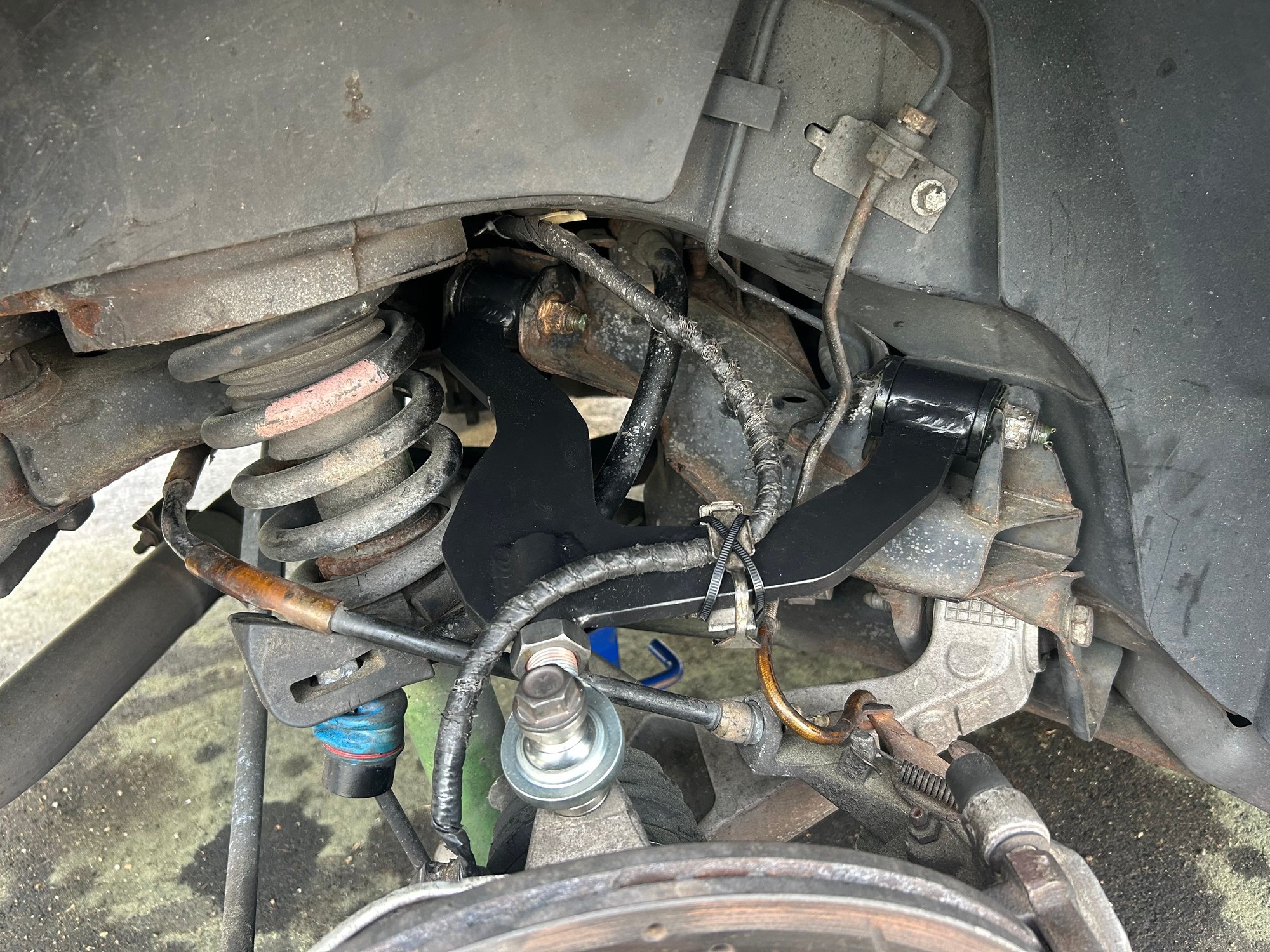

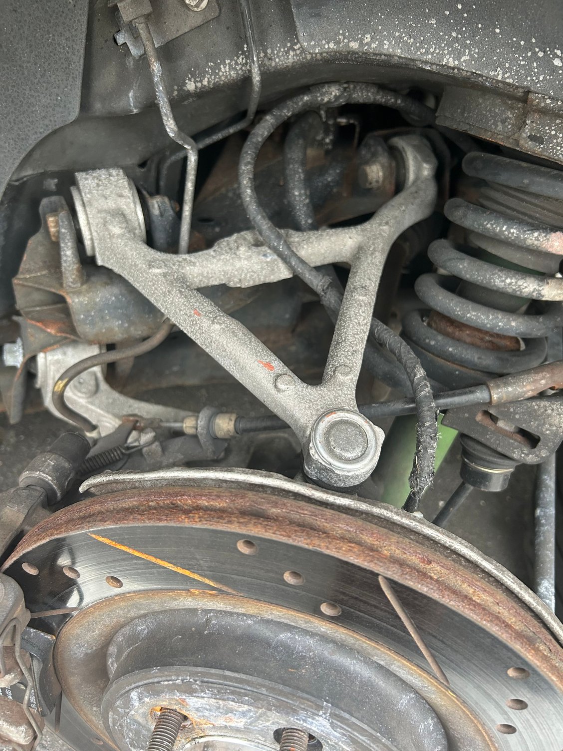

So as you all know the s type from factory has non adjustable rear camber. And for the type R owners that can mean some serious inner tire wear especially if you are running soft compound tires.
but I finally came across a website that sold them for the Lincoln LS, so I opted to buy a pair to test out for the s type, and they fit perfectly.
https://www.stukellymotorsports.com/products/lincoln-ls-adjustable-rear-upper-control-arms-with-replaceable-bushings-set

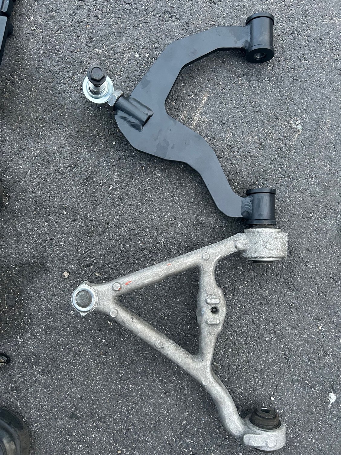

the only minor issue is that will need to zip tie or drill and bolt the leveling arm to the new control arm somehow.
but I am finally running 0 camber in the rear(originally-2). I was going to through soft compound tires once a year due to inner tire wear especially and this should be the cure!

That looks great! Would love a pair like that on mine. You might want to get some boots to cover your rose-joints to avoid premature wear.

Hey great find!
Too bad they are steel compared to the lighter Aluminum arms.

They weigh just about the same as the oem part, but I’m pretty sure they will be stronger than the cast aluminum part.
