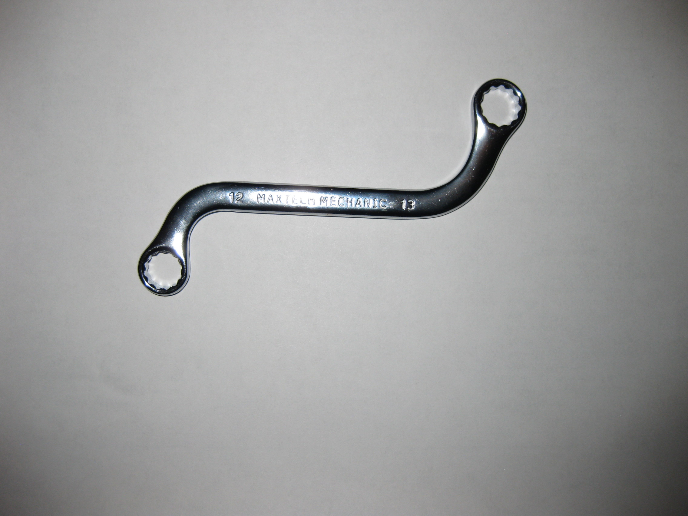

2.)The tool I found most useful in getting the 13mm top bolt loose from the starter is attached. There is room on top of the starter (not solenoid) to get a socket on the bolt, but you have to an exact length of extension to get the ratchet on because the motor mount is in the way. So, I gave up on the socket and after trying every wrench in the box, found this one worked for me.
3.) When installing the starter, remember the socket and extension that was a little too long? Now is the time it comes in handy. Insert the top bolt through the casting hole and attach socket with extension (forget the ratchet, you will use your fingers), position starter in place. The bolt is tapered and finds its place fairly easily if you DO NOT START with the bottom bolt. Finger tighten bolt by turning exposed part of extension. Then just finish tightening with wrench.
It took me hours to get that bolt out before I found the wrench that worked, but only took me 10 minutes to put the whole starter back in.
