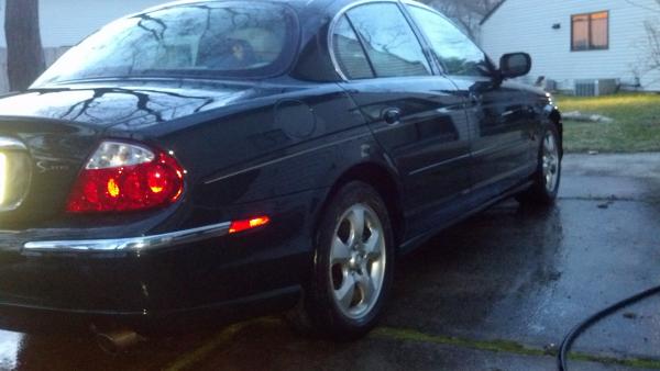

See not so bad for 170k miles, 14 1/2 years old....and all original at least I dont think..
Attached Thumbnails Big problem guys-s_type_r-146786-albums-my-baby-3-9455-picture-all-clean-24444.jpg
