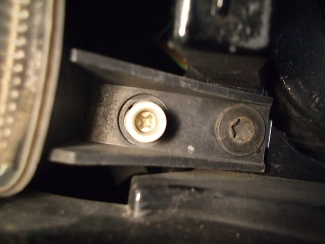

Fog lamp lens and bulb (passenger side) broken. 2005 S-Type (JUST PURCHASED [:@]). Is this a do it yourself kind of job? Any idea of how much it might cost? A million thanks!!

I’m going to say that you can change it yourself how do I know this? I was messing around with the foglights the other day I even took some pics. That white screw allows you that aim the foglight and the other screw is what holds it in place. It's either a T35 or T40 Torx screw, which I didn't have or I would have taken it out for further inspection. Name:  Picture045.jpg

Thanks so much. I looked at bulb replacement in the owner's books and it recommended going to the dealer. Seemed a bit cost prohibitive to have a dealer's mechanic change out a light!
