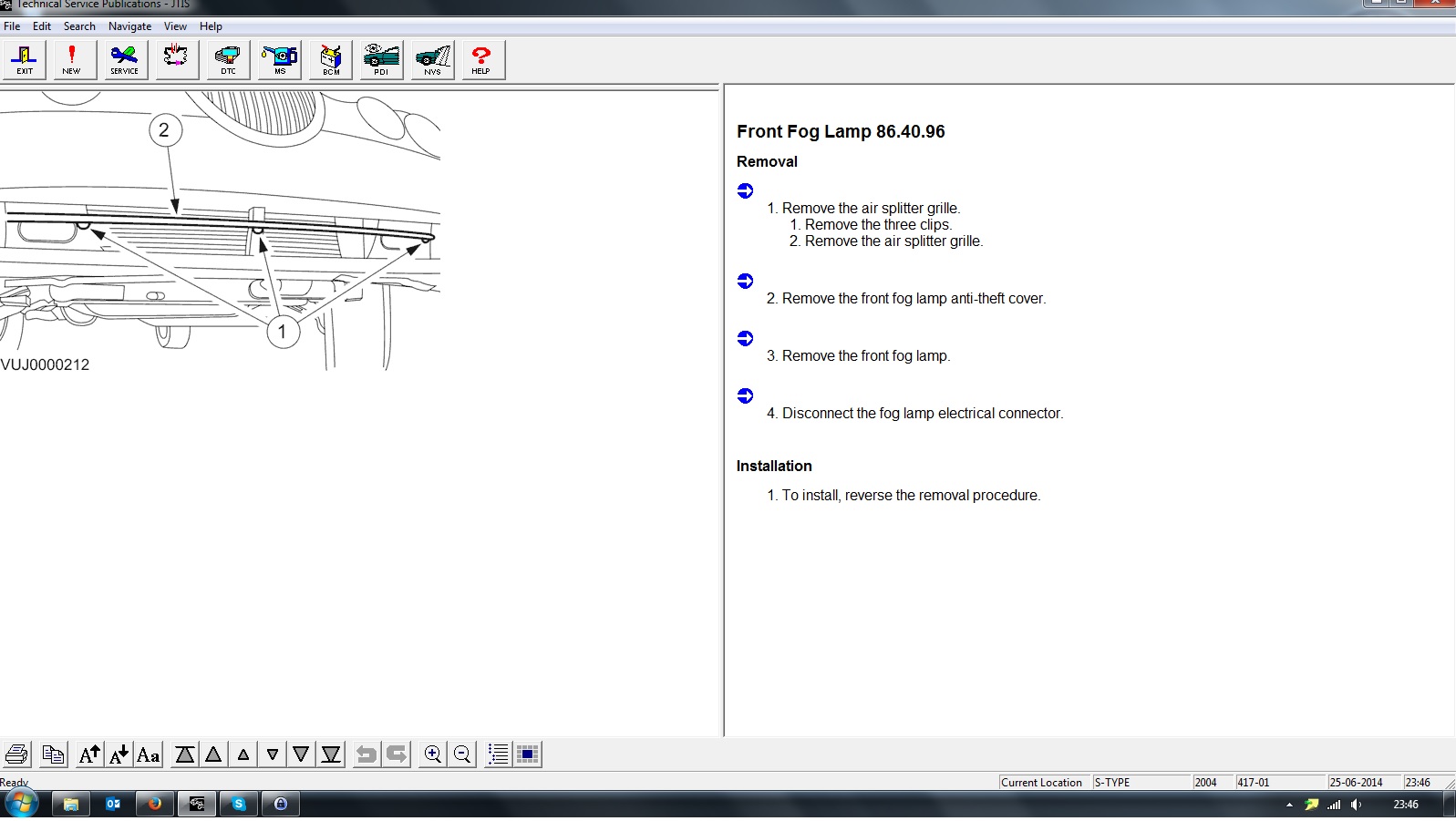

42 Views and 0 Replies as I write this. Doesn't any owner know how to remove the Fog Light?
Here's the procedure from JTIS:
(click on each of the images to enlarge them)

Thanks for the effort Graham.
However mine has the round fog lamps. They appear to be screwed or clipped in from the back. Sorry in the office so cant send a pic. Does JTIS have this version on there?

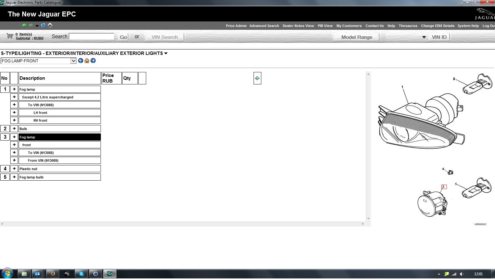

JTIS ends at 2004MY but the current Parts Catalogue has an illustration which could help:
The later round pattern has 3 lugs for screw fixings visible in the drawing:
