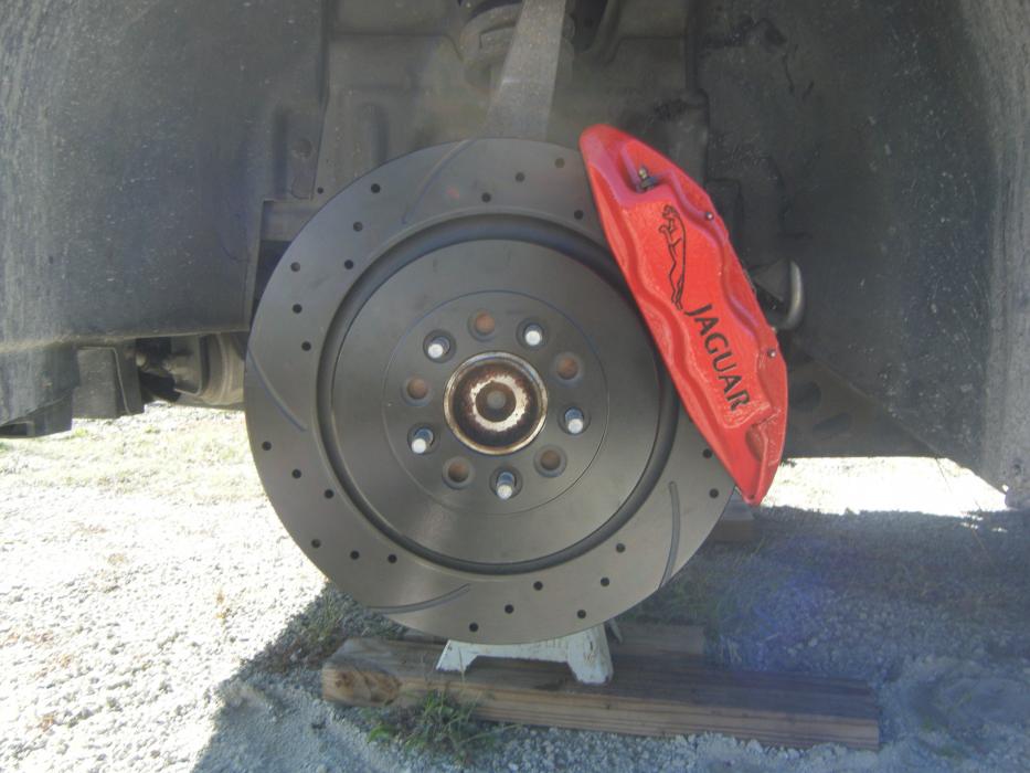

I got the black coated slotted and cross-drilled. I have ran them on my other car and dont get on them hard enough to crack so I couldnt see paying the extra money for the dimpled. Looks alot better then stock. I got it for the bling factor cause I wanted to do something different with the Brembos. Heres what I did.

So you like the look of the cross drilled and that's why you got them?
That's fine with me. But WTF is the pupose of a dimpled rotor?
Bob S.
Old Oct 26, 2010 | 04:52 PM
vance580's Avatar
Posts: 1,445
Likes: 218
From: Atlanta, GA
I think its so they can charge you more. Kidding. I think the purpose of it was for people that wanted the cross drilled look but without the possibility of it cracking. I have had 2 sets front and rear of cross drilled and slotted rotors on my last car and I have never had one crack or even show signs of it starting to crack. They charge almost 100 more just to have dimples instead of it being cross drilled, I'd rather just have the real thing and get them cross-drilled. I think if you hard on your brakes enough to crack them then you probably would of warped them if they were solid. Like I said I just like the looks of it and I felt 459 was reasonable for a set front and rear, not much more then solid. Plus they look nice with the red calipers.
