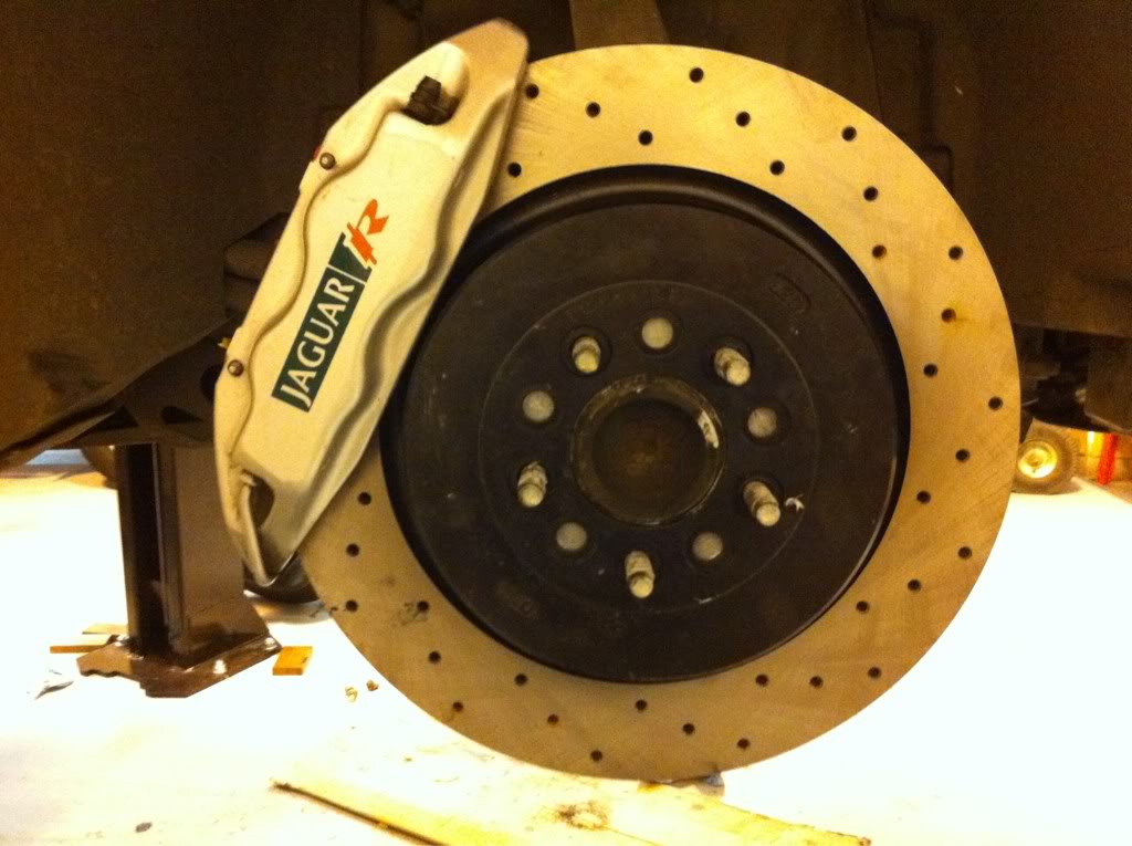

Got all four rotors and pads replaced today. I used the EBC redstuff pads. I am still getting a slight wobble in the steering wheel when I lightly ride the brakes, any ideas what's causing that?

Did you clean the hub really well and look for any surface irregularities? If the rotor isn't running true on the hub ...
You can pick up a dial indicator at Harborfreight to check it out. Then you can begin to figure out what's going on. You might have a bad hub too.
I thought EBC RED was their track formula pad? It used be 10 years ago.

Also, my Redstuff pads have a wobble slightly too. It's been getting less and less, they just have to break-in to the new rotors.
