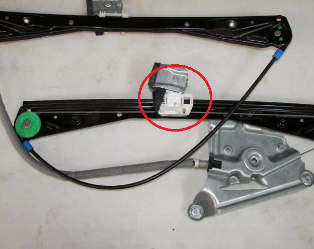

Yesterday, the front passenger window would not go down. I heard a click but no motor sound. I tried it a few times. Today, I tried it again and got the same result, click but no motor. When I got back home, I tried it again and it worked! It went down and up. I did it several times. Is this a warning? Do I have to do something to prevent it from getting stuck in the up position?

2 days ago, I had the same thing happen to me, but in my case eventually I heard a louder noise of something falling down. In my case it was that the plastic clips that hold the window, which had broken down. Causing the metal wire to disconnect from them. Common thing as they get very brittle. Now waiting for new clips to arrive. Also front passenger window by the way.
So look out for that in case you hear a louder noise!
