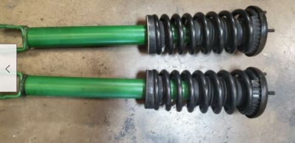

Here is an image of a pair of front shocks, 2003 and newer.
Forks, huh

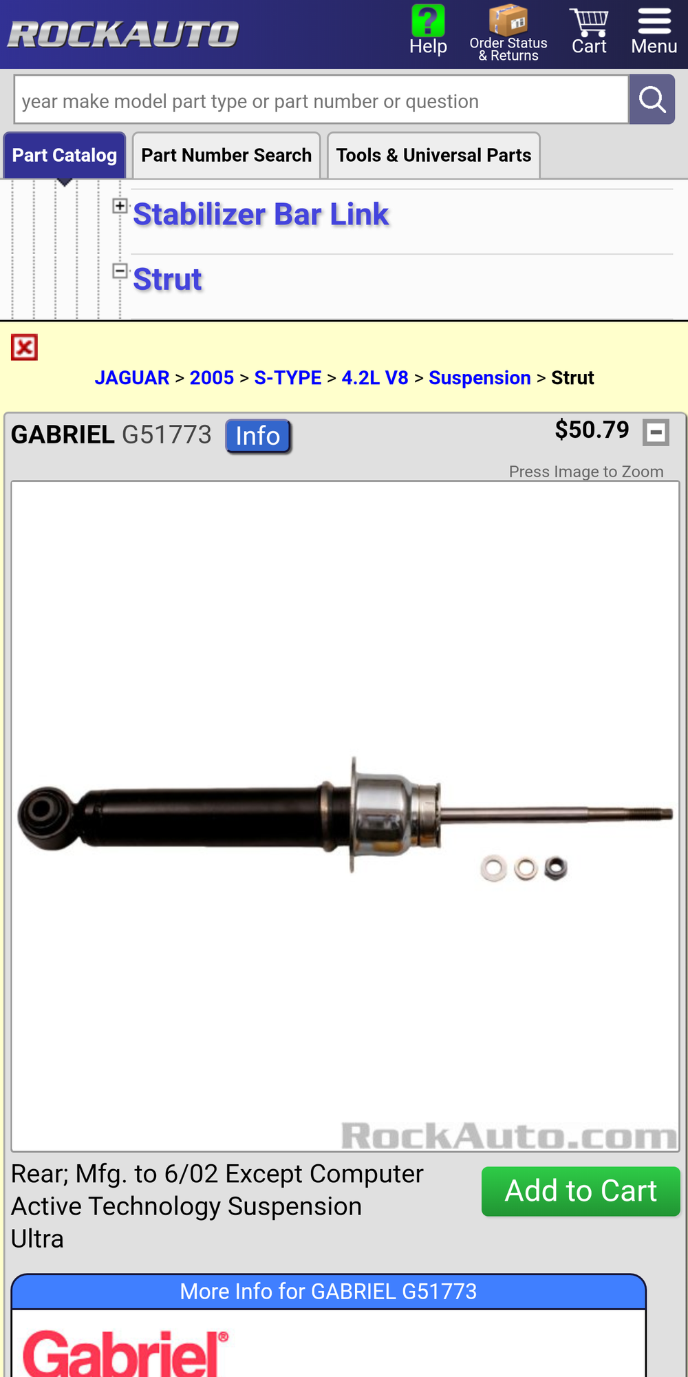

Is there two different types of suspension? Like one active dampening and one not? Because this is what rock auto says it is, and AutoZone has them both listed.

The RockAuto snip is for the rear?

Does you car have CATS active suspension? You can tell by a plug and wire coming out of the top of your struts when you open the hood and the color of the OEM struts are green. (Some cars came with black plastic covers that hide the top of the strut that you may have to remove in order to see.)
FYI; the struts are different in the front for 1999 to 2002.5 S-types - Earlier suspension design
LMAO can't believe I just did that 😂
