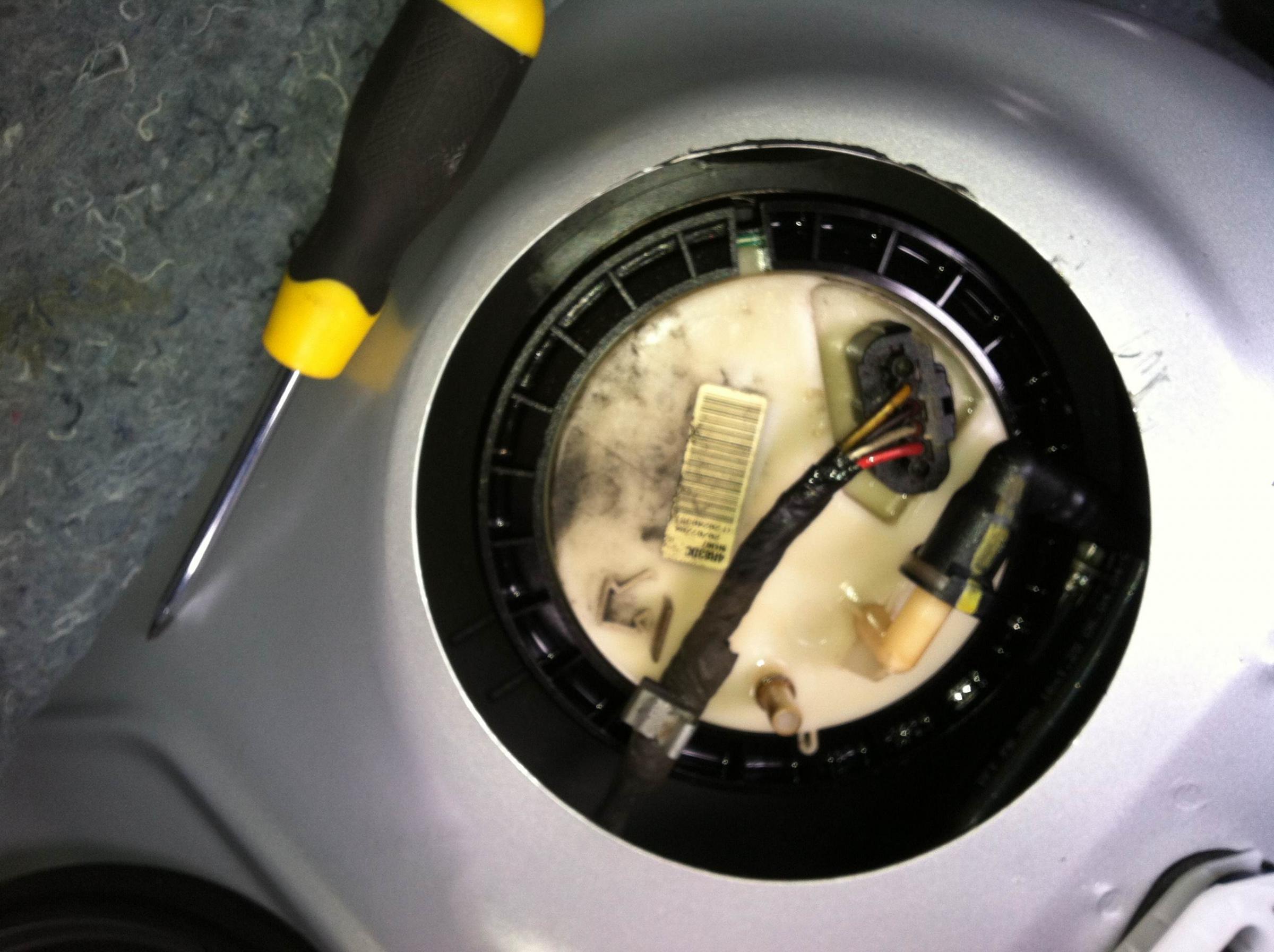

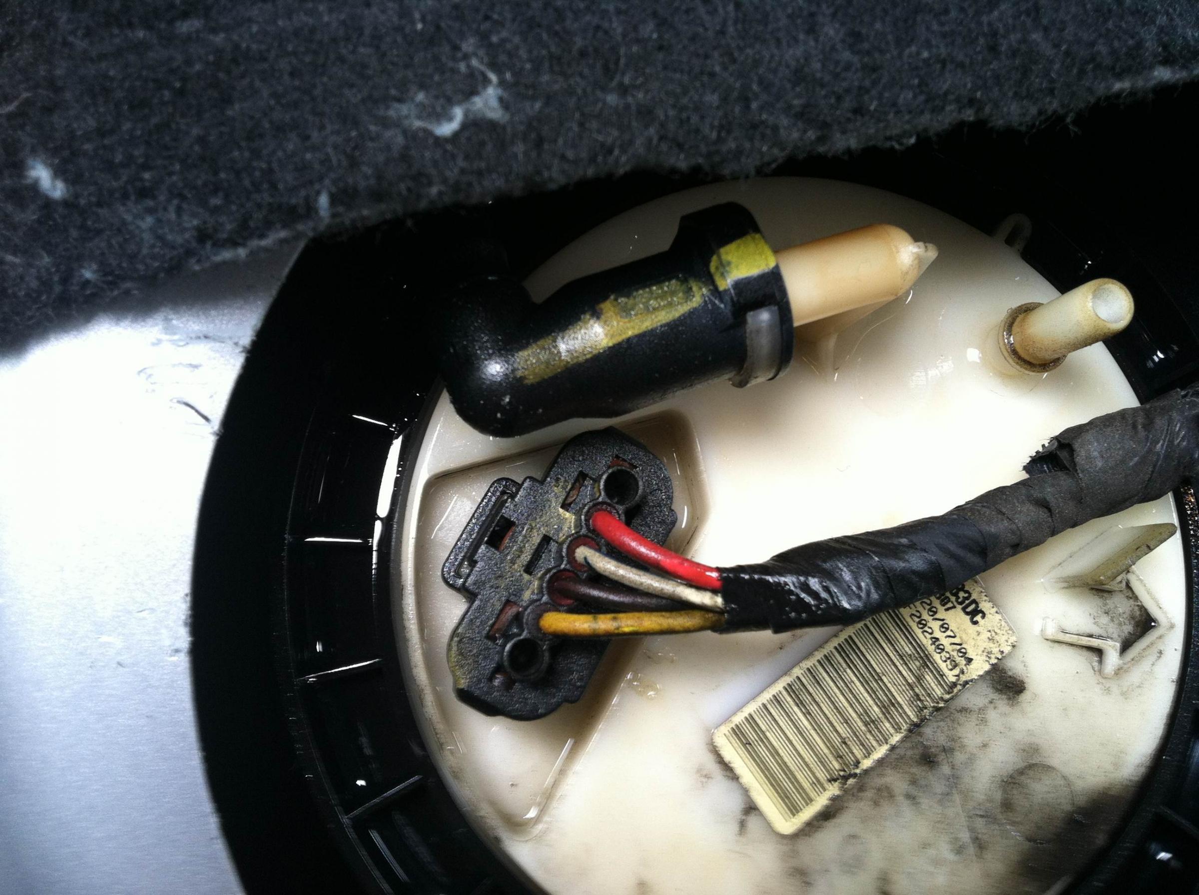

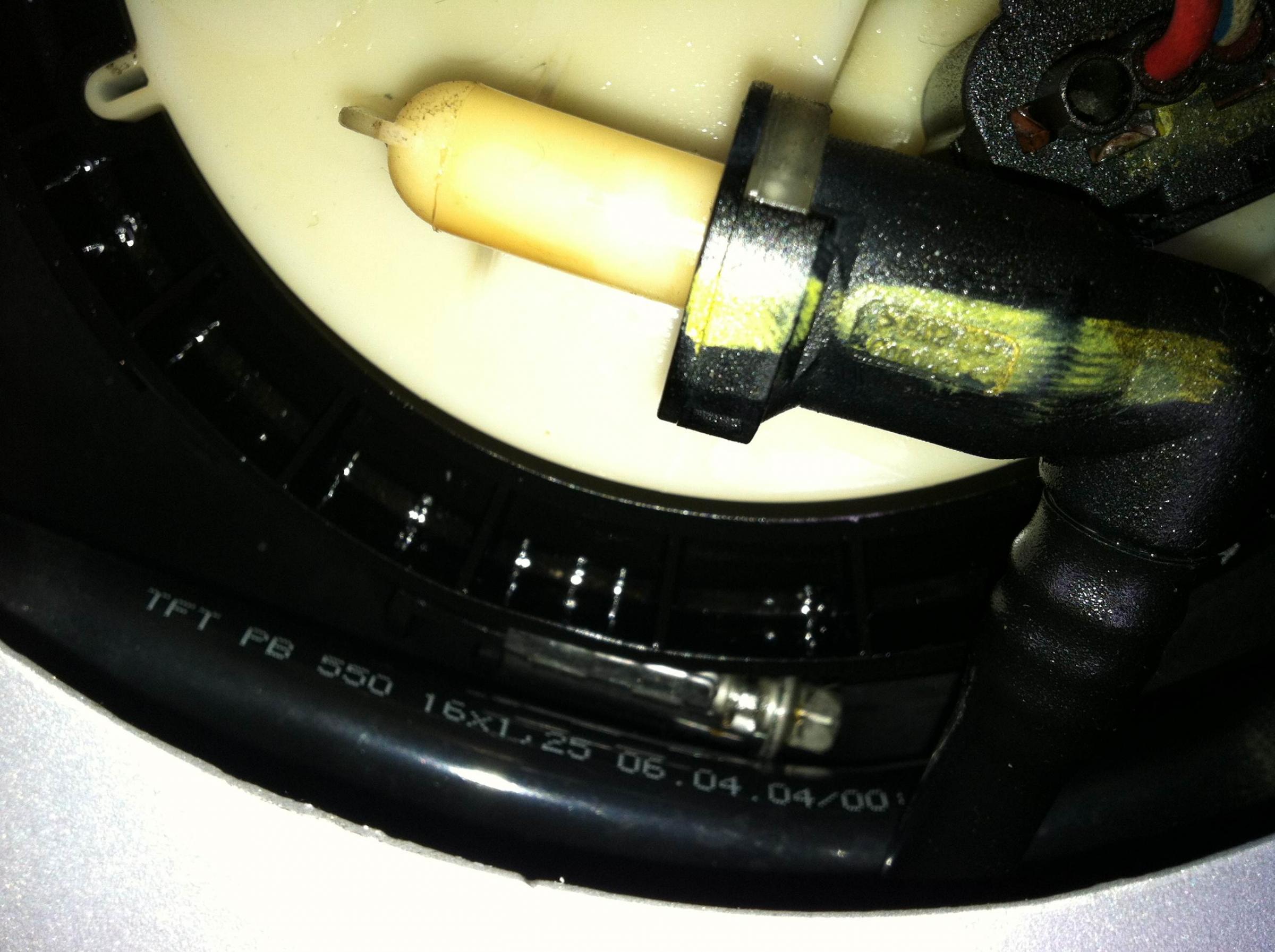

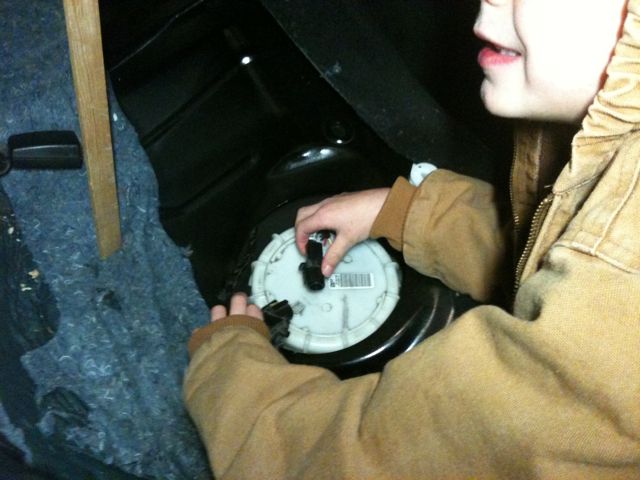

under this seat
remove this cover/seal
disconnect wires

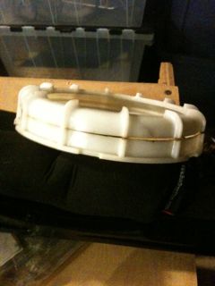

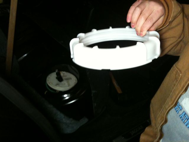

ring removed showing crack

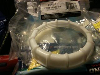

new outer ring
new outer ring pn

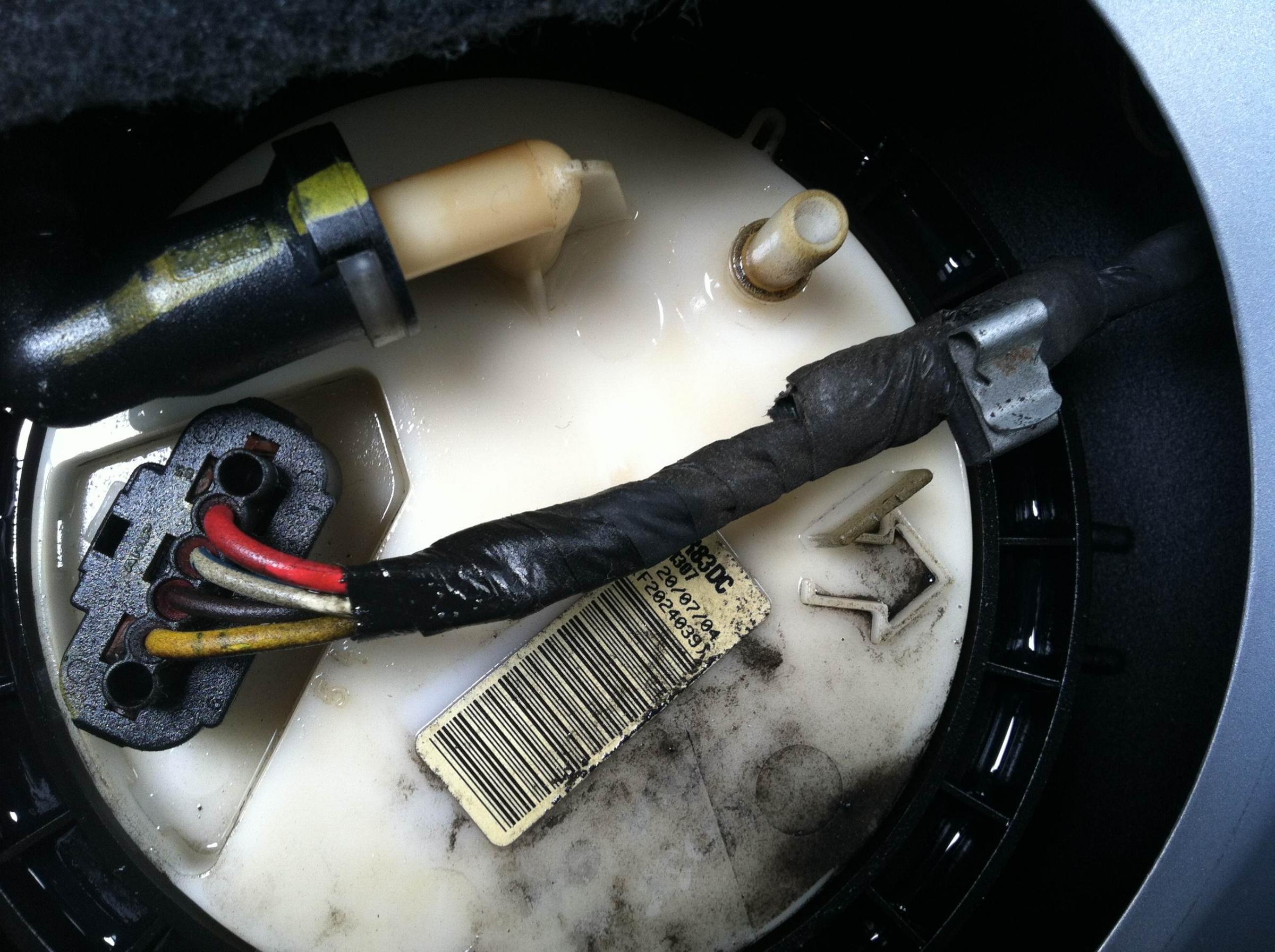

new seal
new seal pn

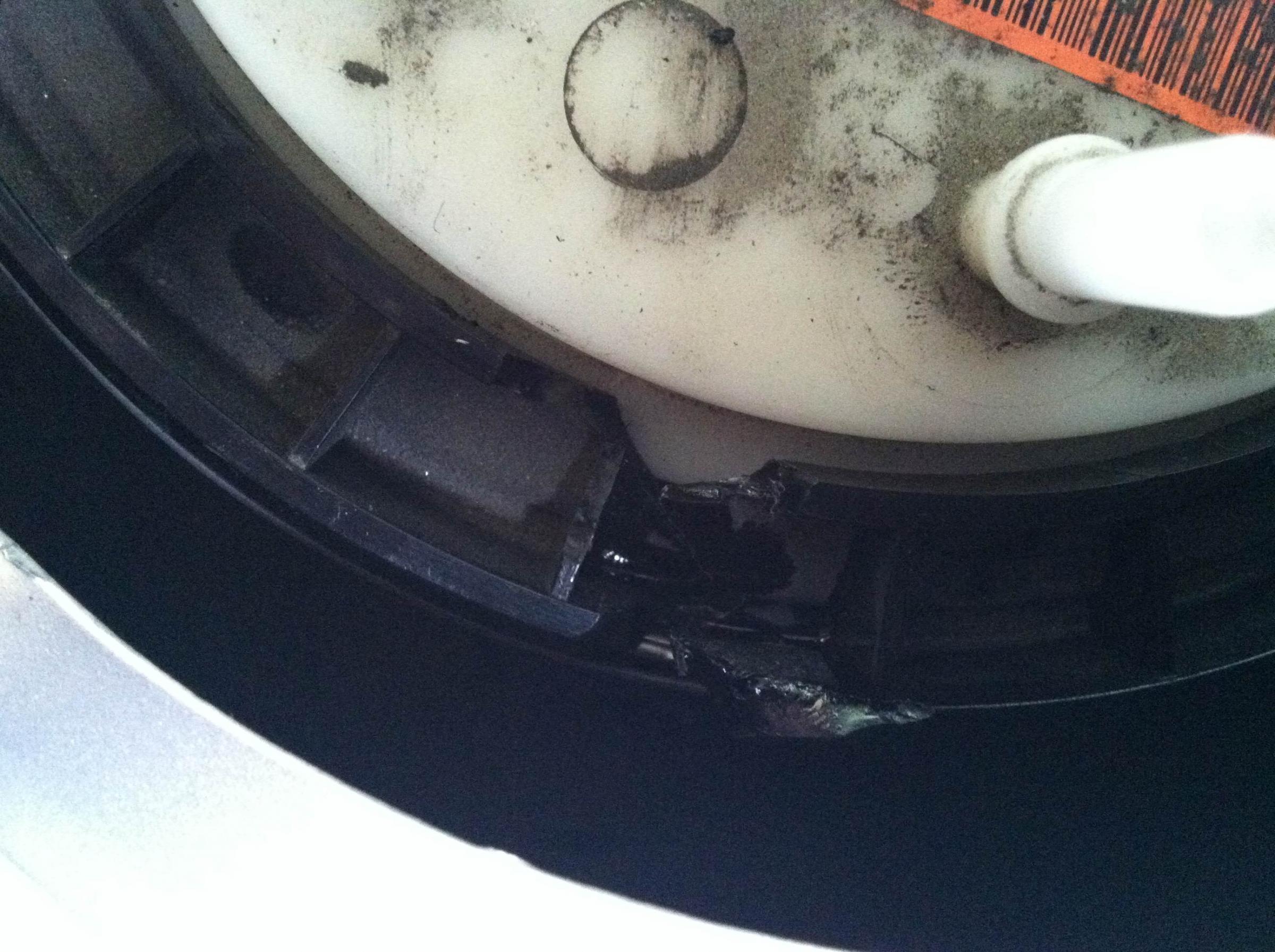

The picture is not super clear but you can see I took a picture of the split retaining ring. I still have the cracked retaining ring as I did the work myself, not the dealer.

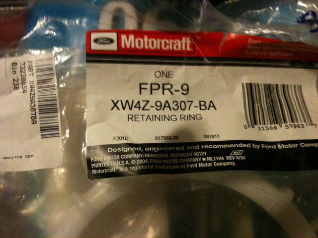

It's taken me a while, but I felt this would be relevant to all members. I too developed a fuel smell "INSIDE the Cockpit" of the car which seemed to get strong and stronger over time.
I noticed after a while my mileage going down too, i.e. trip from Rockville MD to Harrisburg PA straight up 270 and 15 driving very spiritedly, would burn about a quarter tank of gas. The trip is about 129 miles door to door not withstanding some radical traffic.
Suddenly, my fuel consumption went up and the smell increased. I followed 1320racer's guide believing my problem was the same and it was. The problem for me, however, was my fuel pump assembly and float were "different", so the parts I bought I couldn't put on to fix my problem.
It appears with the original recall on my tank, they replaced the tank but never the fuel sending assembly so I had the same stinky part on that was considered faulty in the first place. I'm attaching the pictures of the problem so all can see and you should well know, Jaguar in Bethesda Maryland, fixed the problem at no cost to me.
The first photo shows the cracked ring on the float side which was beneath the back seat behind the passenger seat of the vehicle.

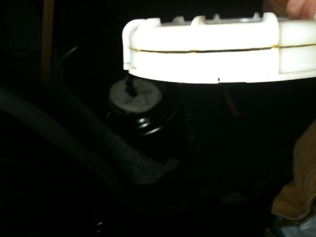

The next photo shows the Fuel pump assembly itself which was beneath the back seat behind the drivers side of the vehicle. As you can see, the fuel pump side was very "juicy" and an absolute danger because there were electrical wires to feed the pump there.

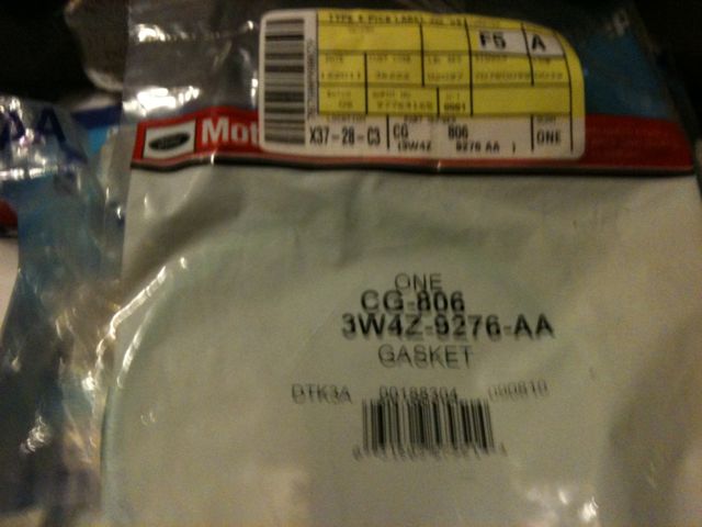

If anyone needs the parts that 1320racer specified, I have one rubber gasket and one plastic seal I'll offer for free but you'll have to pay the shipping. Truth be known, this problem is really Jaguar's problem and we should not be required to repair this problem ourselves.

I suggest you get pictures. It's very easy to do. The 2005's have two latches (if you run your hand along the seam where the seat cushion meets you'll feel that latch. There is no tool required to release the latch, simply pull it and lift the seat.
Do this on both sides, driver and passenger, then refer to the photo's 1320racer has where his son shows the rubber divet. Use a screw driver to pry beneath it and remove it. Take the photo's (mine were taken with a cellphone) print and give that to the dealership. Any diagnostic required to make sure things are right and in order should be "included" in the recall repair and not be an out of pocket charge to you whatsoever.
