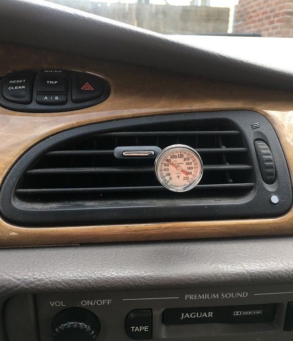

I keep one of these inexpensive thermometers in the center vent. It really helps keep an eye on the actual temperature, versus what I think the AC might be doing at any particular moment:

For all we know, the current fault may be totally unrelated to any of the previous work. You can do a LOT of the steps in that guide with nothing more than a cheap pocket thermometer. For even better results, beg, borrow, or steal an infrared thermometer for checking the temperature of the coolant lines to the heater. In the guide, please start by first doing the steps in post #2, which makes sure the DCCV is operating properly. After that, use a thermometer in the dash to determine if you're getting some cooling (duct temp lower than ambient, even if not fully cold), or no cooling (duct temp equal to ambient). Also try playing around with the system in manual mode, which bypasses some automatic functions and is a boon for troubleshooting. Don't convince yourself the problem is related to past work. Go in with an open mind and troubleshoot based on the present symptoms.
