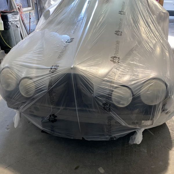

PS, you may have noticed I've become more active on the forum. That's because I finally got my car! :-) I know a new car thread is worth nothing without pics, but my car is in the body shop getting a few minor cosmetic things fixed. I'm hoping to get it back next week. As soon as I do, I'll be sure to post a ton of pics. In the meantime, here's a tease!!

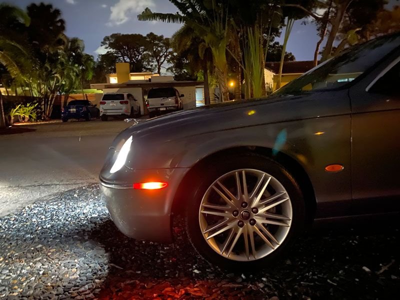

Hi guys, I just wanted to circle back and update this thread. I ended up installing Sylvania SilverStar zXe on the headlights (H7) and fog lights (H11). They were plug and play and they work AMAZING! Sylvania claims "HID attitude." I wouldn't go that far, but the performance is definitely white and bright! Here's a pic:

Word of warning. Those silverstars burn hotter and die quicker. I had a pair go out just over a year. Right after the warranty expired. Never again. Well now I have HIDs but you know
