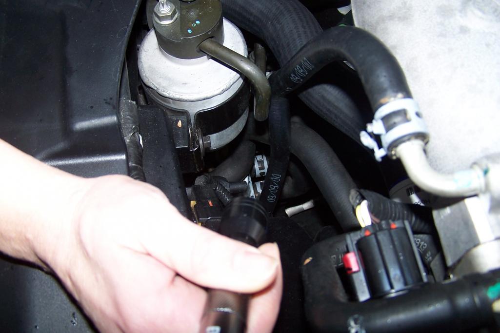

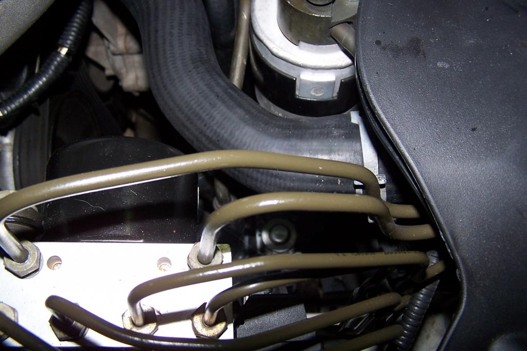

Here are the pictures of the Dual Climate Control Valve on my 2001 S-type 3.0 it should be the same as yours. Also if your going to get a new one check the Lincoln LS cross reference post I found that the Motor Craft DCCV is about $50 cheaper than the Bosch Valve.
Also make sure you check fuse 1 (10 amp) power distribution block engine compartment passenger side. Its probably good but it is an easy check. With mine when the fuse was blown I had heat all the time on both sides just the oposite of you.
heating and cooling-100_8720.jpg Under the receiver drier not a good picture!heating and cooling-100_8721.jpg Under the upper radiator hose if you look closely you can see the top of one of the 2 valves.
If you are going to replace it you are going to need to jack the car up or use ramps and both belly pans will have to come off. You will be able to see the DCCV real good with both pans off.
