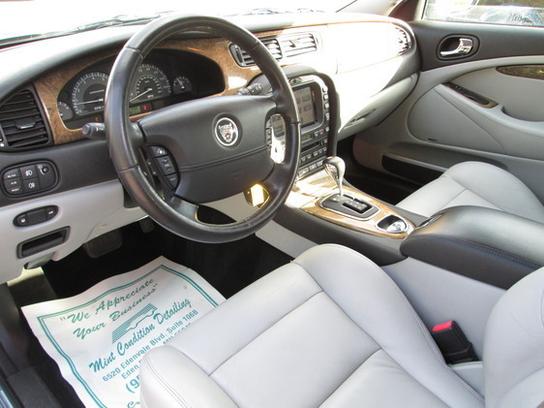

Hi everyone. I have been lurking around her the past month and it’s time to introduce myself. I have a 03 STR 95k on the odomiter. I am loving it. I came from a 02 M5 so there have been some handling differences but the STR is a step up in comfort and ride. I see a break job in the near future with a possible stuck front caliper so I will be looking for any advice. I also have a weeping oil cooler hose that will need attention. Other than that I have put 2500 on her and I love it. I included the mandatory photos
