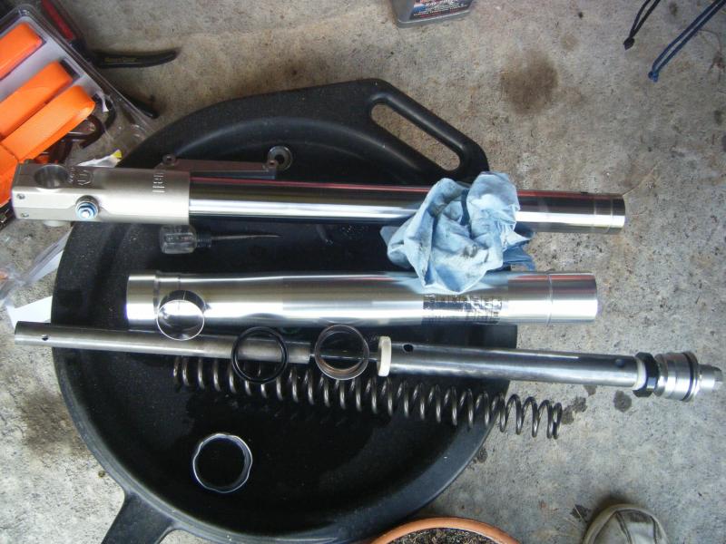

School. LOL. Pretty busy semester. I ride my bike everywhere to save miles and gas on the STR. The STR has become a once a week to once every 2 week vehicle for me. Makes me love it more though cause when I get in it its like revisiting an old friend. I've had to fix some stuff on the bike so I had been lurking their boards for a bit to get some info for fixing. Now that I got that fixed 2 weekends ago I can come back here and post. Just to show you what I had to deal with last Sat.
