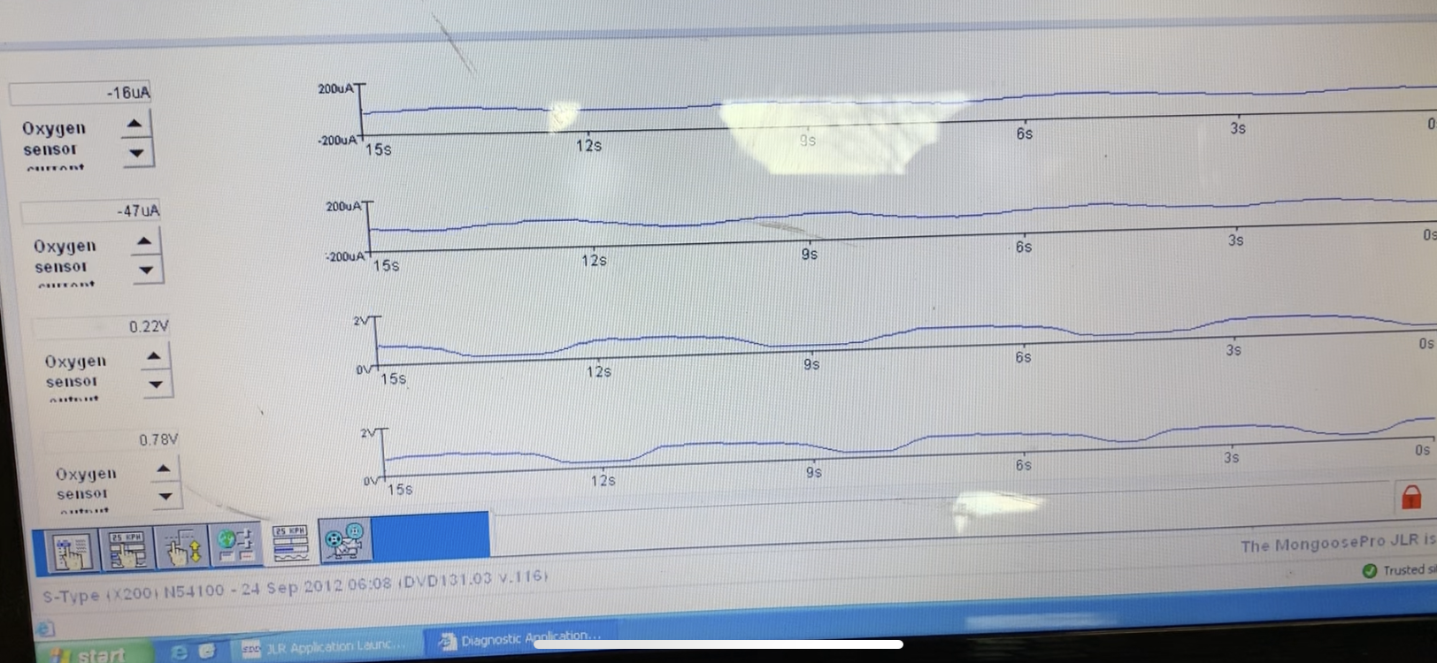

Heres the o2 sensor currents and voltages. You want sensor 1 currents and sensor 2 voltages

oxygen sensor current ( B2 - S1) -0.05 ma oxygen sensor output voltage (0.730V B2 - S2)
oxygen sensor current (B1 - S1) 0.20 ma oxygen sensor output voltage ( 0.125V B1 - S2)

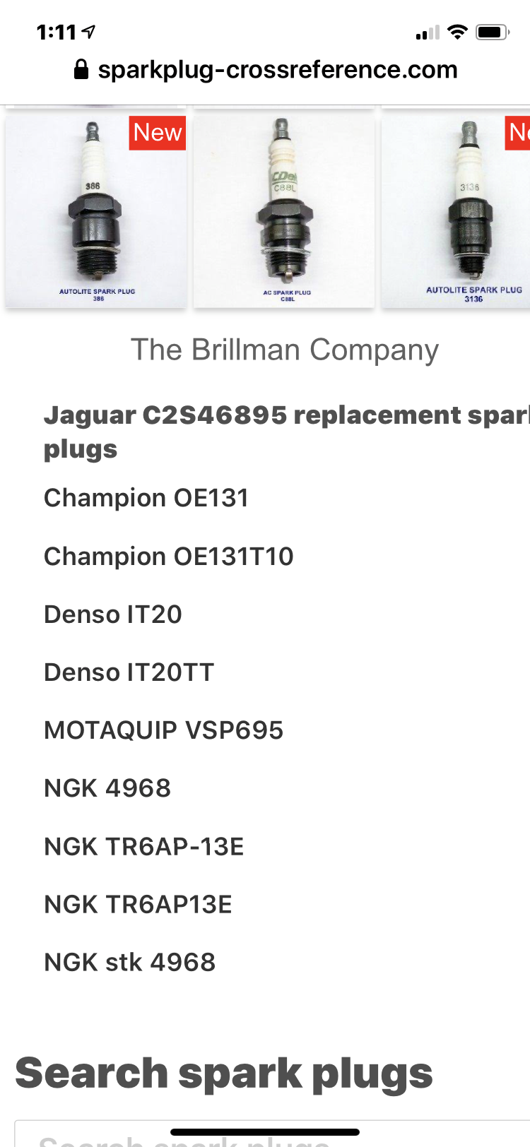

The stock plug is an NGK. Get thise.

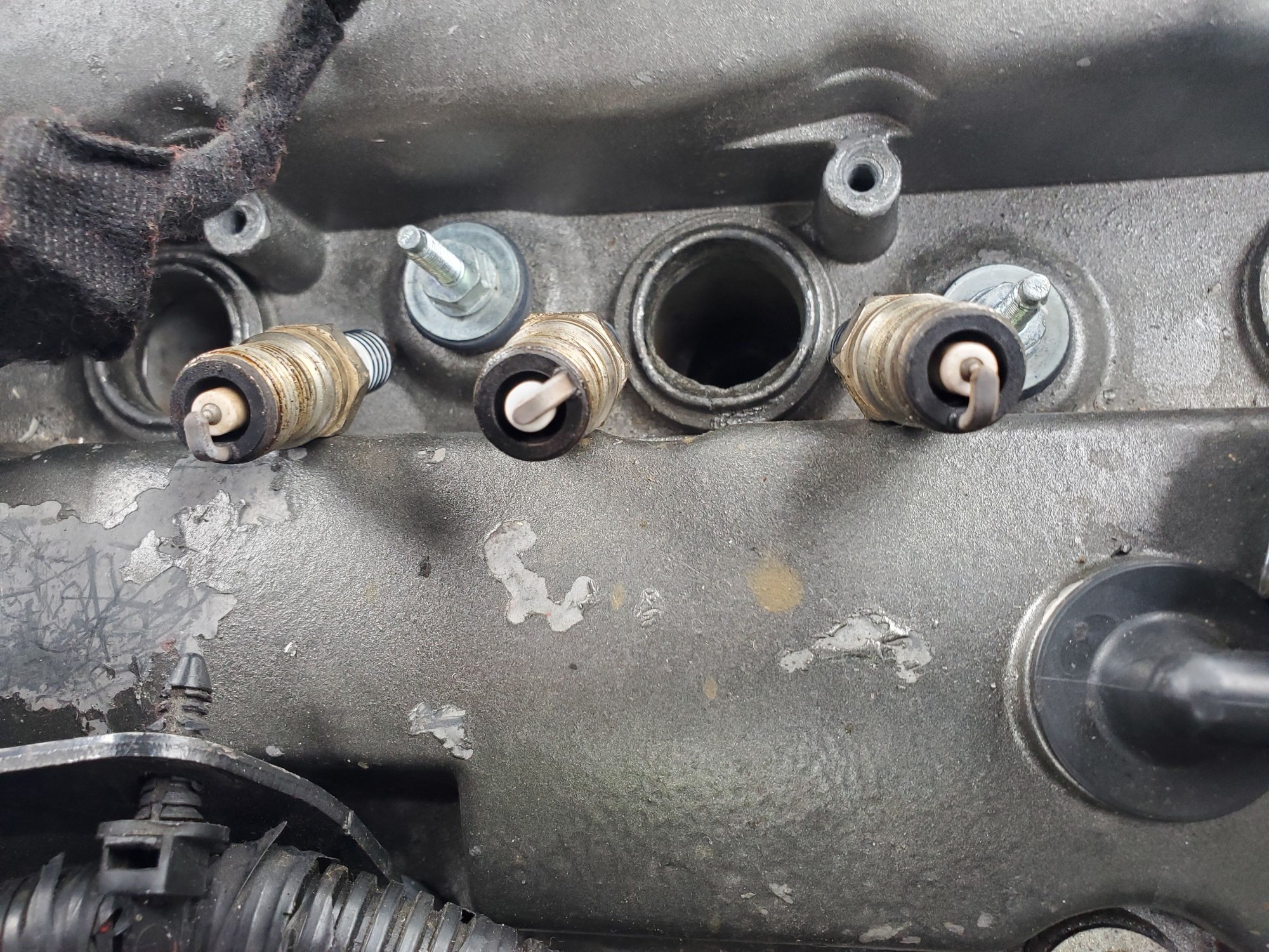

these how the old spark plugs look .. I got the new plugs today … I also took another compression test
these is how they look :
cylinders 1,3, 5 180, 180, 180 psi
cylinders 2,4,6 200, 210., 200 psi I just read ; as long as no more than 20% between lowest and highest and above 135 psi " is considered acceptable numbers "

I’m not too excited about those compression numbers but I don’t think it’s the cause of your problem. In my opinion those plugs look great. Maybe a little light I’d like to see a little bit more brown on the white insulator but they don’t look overheated and they definitely aren’t rich. So if you are getting a rich indicator on your DTC it’s not reporting an actual richCondition it might be a bad O2 sensor thinking it’s rich. Or it’s rich and it is being fixed by the computer but I’m not sure how all that algorithm works. But you’re definitely not running rich
