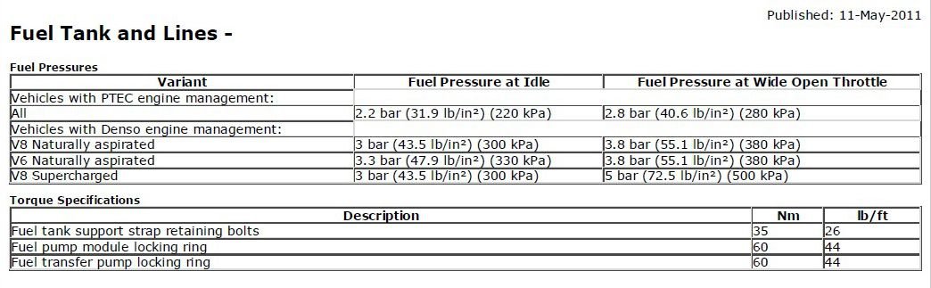

Use a smart phone with the Torque app connected to the PCM via the OBD port with a Bluetooth interface to determine the fuel pressure. It should be slightly over 3 bar when the ignition is turned to the ON position without engaging the starter.
Here are the fuel system specifications for the X200/X202:

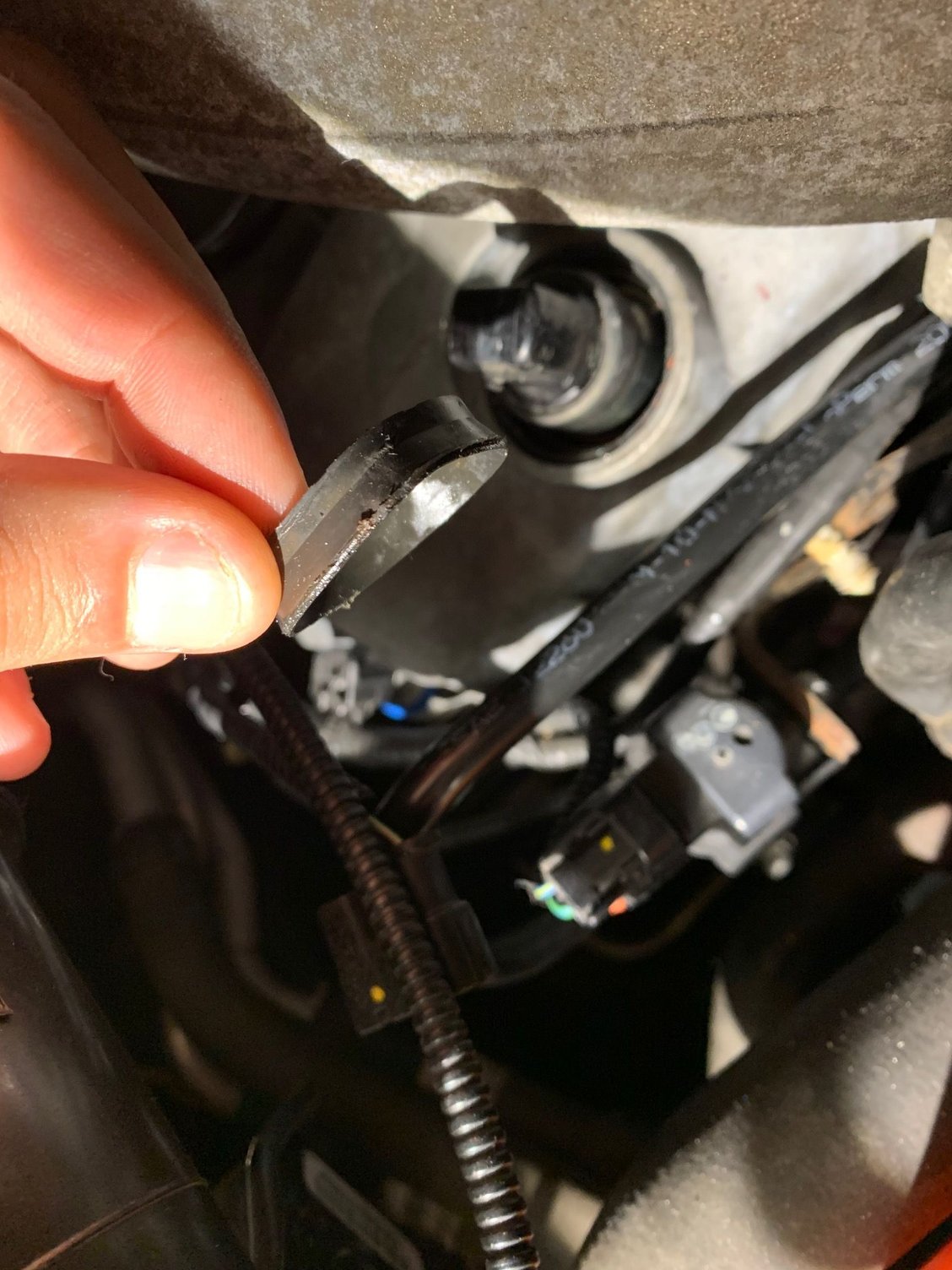

So I gave the car a better listen and sounds like a lot of air leaving the engine when starting up and stalling out. I am leaning toward the gaskets for the valve cover electronic connections (can someone please help me with this part). I believe the rubber tore as I pulled the covers off. Can someone point me in the right direction for replacing these two gaskets?

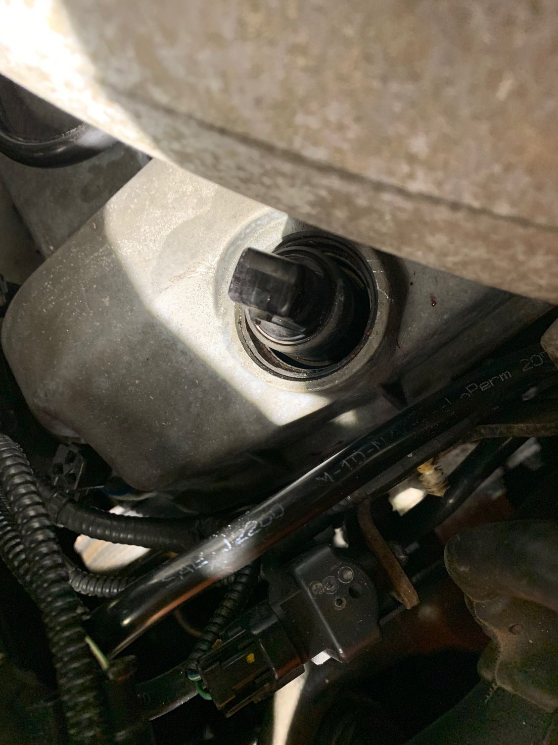

Okay, so i've pinned down the VVT rubber seals, they had tore when I took the valve cover off. Now it looks like the outer old vvt seal baked into the hole. Anyone have any recommendations for taking out the stuck portion of the seal?

For taking them out I'd just carefully use two picks. One to dig / bend and the other to pull.

I managed to tap a thin screw driver behind the metal ring and bend it in and rip it out with needle nose pliers. the sucker was in there good.
Could someone point me in the direction of the part number for this gasket? Hoping this is the cause, as it was easy to change them without taking anything apart.

The part is called a "Solenoid to Cover Grommet AJ82577"
