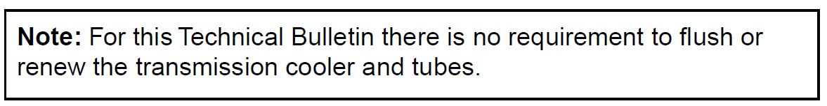

Well maybe not? I read further in this TSB.
So Jaguar does not think there is any debris? Or maybe it gets stuck in filter?
clubairth1, I very much appreciate you finding this note. I actually found the TSB as well on a previous thread where I believe you might have posted it, but failed to read that key point. Interesting, and more results to come as I work through this.

Now the updated seal was new to me and I wanted to learn exactly what is failing in the TC.
We have had people drive quite a while with this problem. But it does not seem to cause other problems because they swap the converter out and it's all fixed.
Still sounds like there should be something coming off the lining as it fails?
