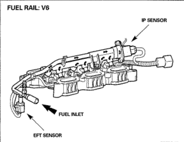

Aha. might be http://i208.photobucket.com/albums/b...S/JagV6_23.jpg

While you found the above, I had popped Joyces hood (bonnet) and removed the black plastic engine cover. The fuel rail system is somewhat hard to see because of the intake manifold, but as your attached diagram shows the "EFT sensor" right up front. With the fresh air intake tube removed, looks pretty easily replaced.

It is directly under the schrader valve
The EFT sensor, located on the fuel rail, is a thermistor which has a negative temperature coefficient (NTC) . Fuel temperature is determined by the PCM by the change in the sensor resistance. The PCM applies a 5 volts to the sensor and monitors the voltage across the pins to detect the varying resistance. The PCM uses the EFT signal to adjust fuel pump pressure to prevent fuel vaporization and ensure adequate fuel supply to the injectors.
I hope this helps!

Get rid of the fuel pressure by releasing it at the scherader valve first and that is on the top side of the fuel rail above the EFT Sensor. I would also suggest doing this when the engine is cold and I would have a few rags under and around to capture the fuel that will spill out when removed. When installing the new one take your time and do not over tighten or cross the threads. Caution should be taken not to twist the rail when removing or installing. Take your time all will go well. Be sure you do not have fuel that is pooled on the engine and leave the hood open to evacuate any fumes and look for leaks.
