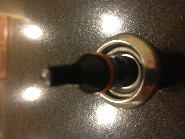

Just pm'd Gus but if anyone else knows how to get the eft sensor off it would be helpful. Doesn't have threads to turn. Just has a little rubber gasket and a spring around the base. Don't know if I should try to pull it out by force or if there is some trick with the spring

Can you post up a picture of the new EFT? Might help in figuring it out, without the plastic protective cover.

Ok, here's the pics
Attached Thumbnails Help w/ p0182 Fuel temp sensor 04 stype 3.0-img_0679.jpg   Help w/ p0182 Fuel temp sensor 04 stype 3.0-img_0680.jpg   Help w/ p0182 Fuel temp sensor 04 stype 3.0-img_0681.jpg

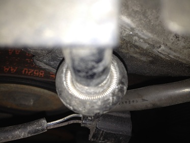

i got as far as the remove temp sensor but not sure how to get it off. it doesn't unscrew. Just has the spring at the base. Just need confirmation if I need a special tool or if i can just pull it off with a little force.

There is a spring unlock clip on the fuel line going in but not on the sensor itself.

Here are the pictures of the sensor on the rail
Attached Thumbnails Help w/ p0182 Fuel temp sensor 04 stype 3.0-img_0687.jpg   Help w/ p0182 Fuel temp sensor 04 stype 3.0-img_0688.jpg   Help w/ p0182 Fuel temp sensor 04 stype 3.0-img_0692.jpg   Help w/ p0182 Fuel temp sensor 04 stype 3.0-img_0693.jpg

Can anyone help me out please. I'm still stuck on how to get this off. Don't want to break anything.

It looks like now that you have the clip removed all you need to do is twist the unit a little as you push it out. Be sure to unplug it first.

Thanks Gus, I just posted another thread as you answered this one, There wasn't a clip on it. Just the connector. I've spun it and twisted it, tapped it and it won't budge.

After digging more into the jtis I have found that this is called a spring lock coupling and it requires a special tool to take off and put on. I hope I didn't damage anything

Good news is that the red tool worked like a charm. Just trimmed down the edge a little bit. Got it back on and and everything put back together in 5 mins. Bad news is I cleared the check engine light and after a couple If restarts the light came back again with the same code. P0182. Now I'm stuck.
