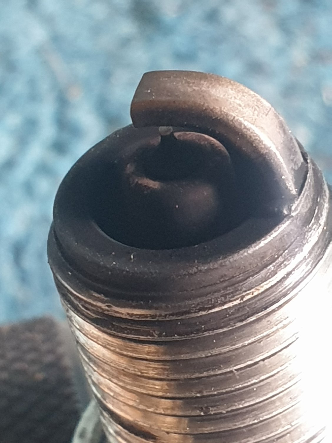

photo one plugs on bank one 1 3 5 7 all like this

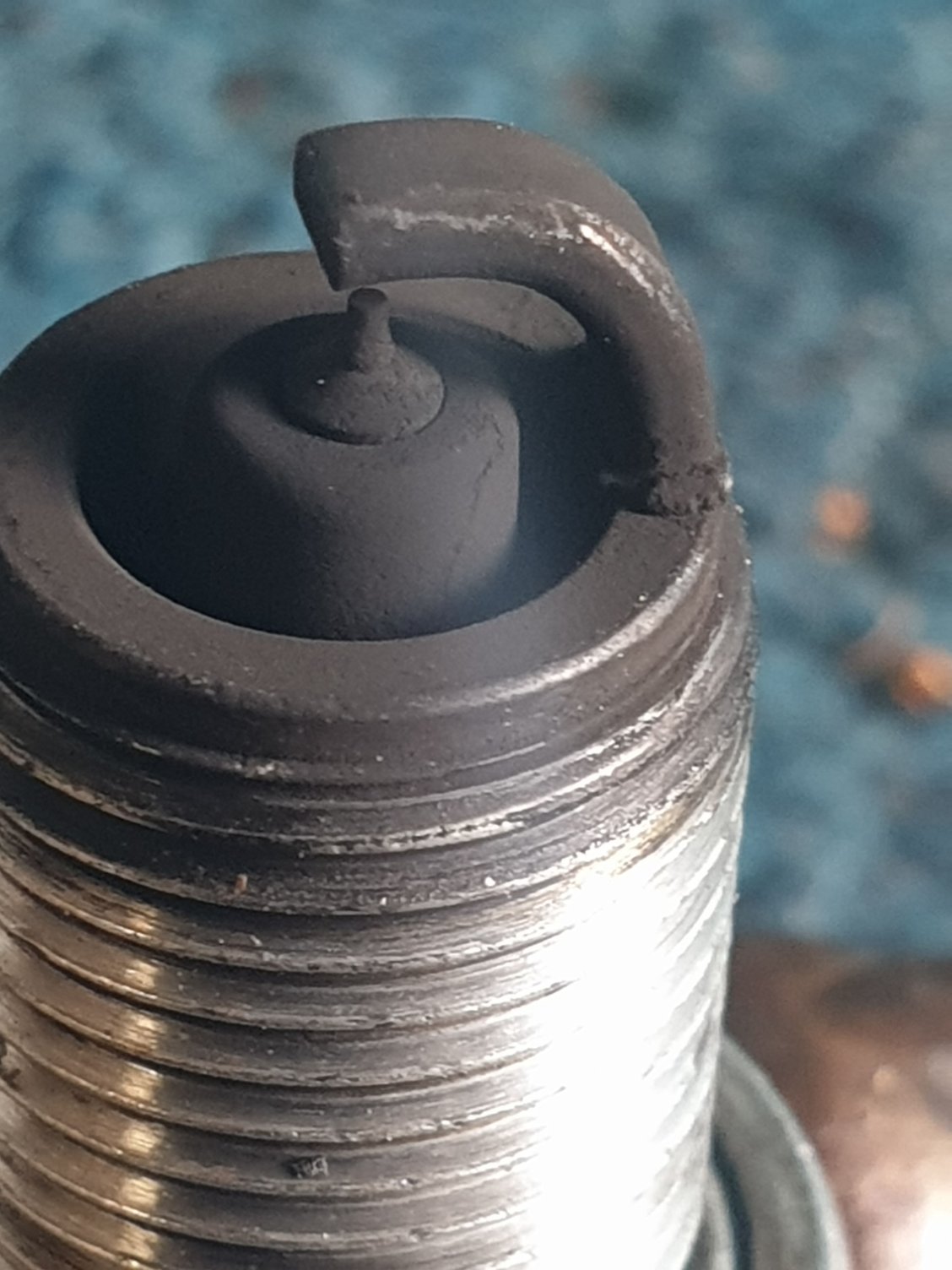

Photo 2 plugs on bank two 2 4 8 all like this

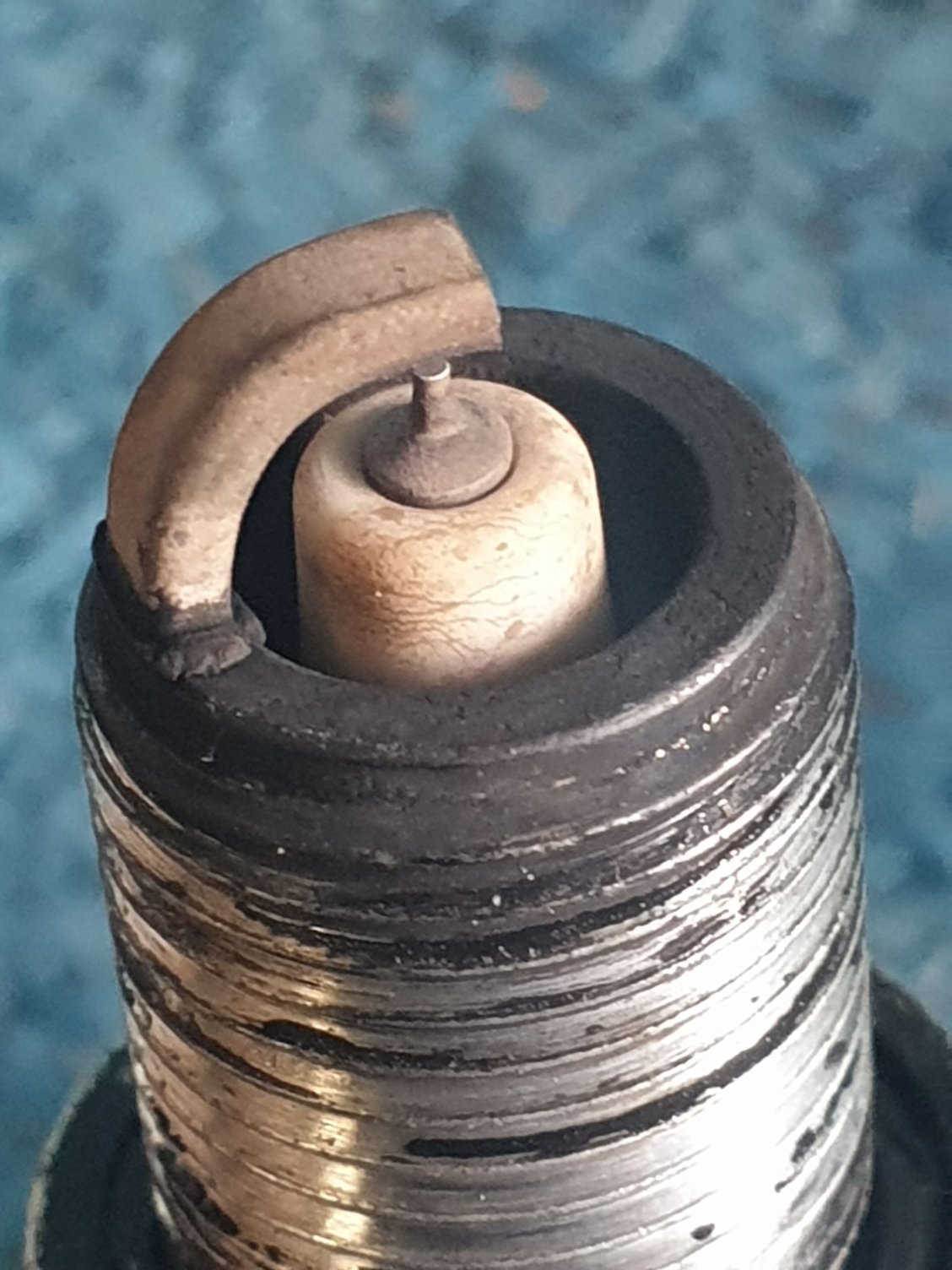

Photo 3 plug 6

First thing I noticed is you gained extra faults after changing all those parts. You went from a single cylinder misfire (low power*) to four, all on the same bank.
What would affect all four cylinders on one bank but not the other? Considering you just replaced the O2 sensors, I'd suggest swapping the two upstream sensors and see if the fault follows to the other bank. You may have got a new sensor bad from stock, or there was a problem with the connection. Revisit all recent work, swap the two sensors, and see what happens.
