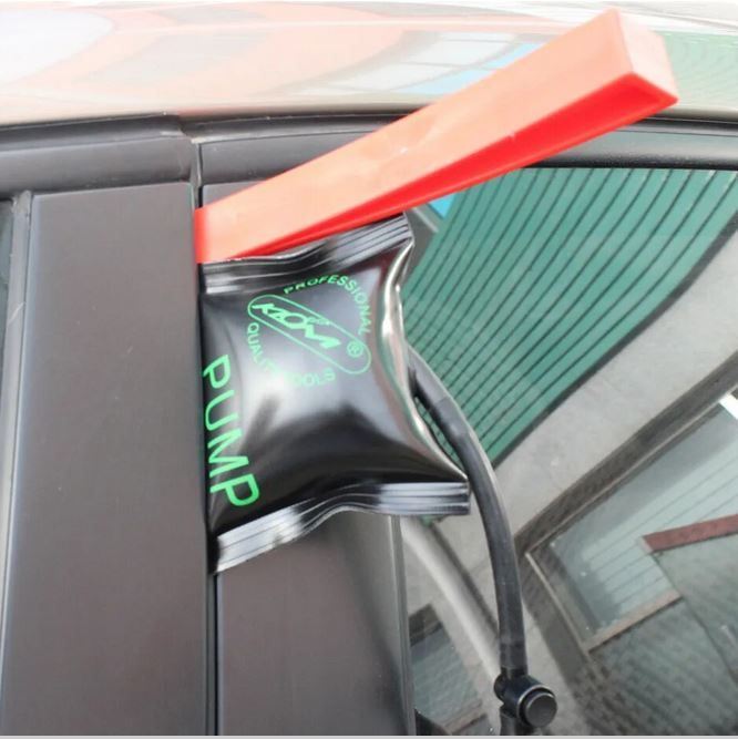

Your car has folding rear seats? Even the R's do but the cables are all hidden behind the trim panels in the trunk.
Maybe release the back seat back and push it forward from inside the trunk?
Then if you have power you can push the door lock button(Somehow?) to open the car?
You can also use the lock smith trick of inserting a small inflatable bag in the drivers door frame. The pump it up until you can snake a wire down and press the unlock button?
Dozens around for cheap too?
Locksmith Air Bag Locksmith Air Bag
