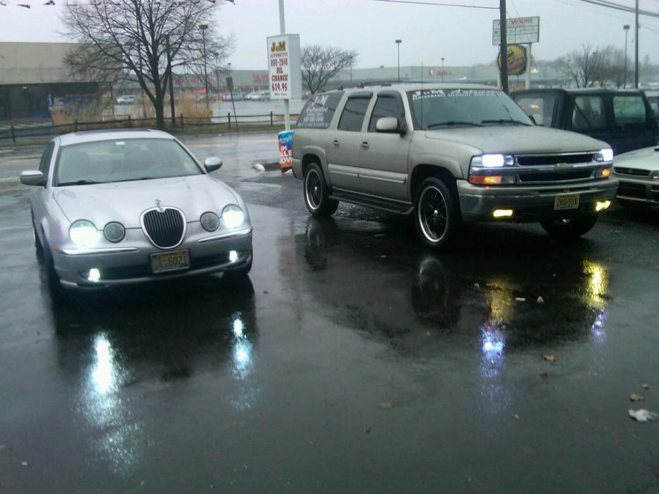

Yes they will work fine. I have DDM HID's in my head and fog lights. I did 600k but if I had to do it again I'd prob go 4300k.
Take care,
George

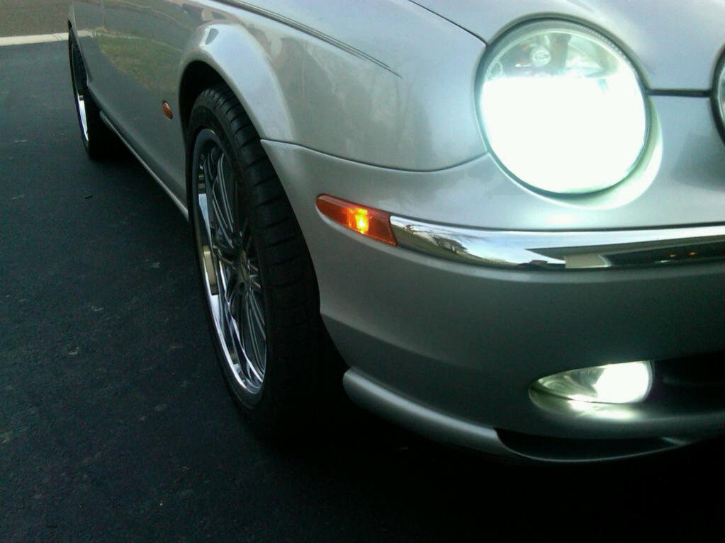

Yeah I did both at the same time. Used another DDM kit. The bulbs SHOULD be H3, but pull one out to check and make sure.
My Jag has 6000k in this pic - both head and fogs. My brother's suburban has 12k headlights, 3k yellow fogs.
George
