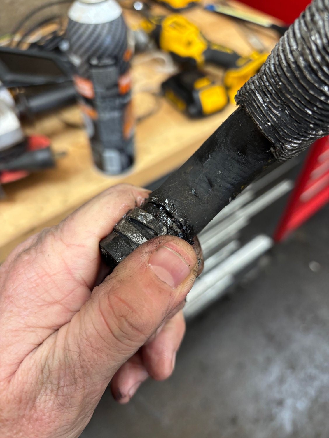

Default Actually the reservoir fill line is bad
Managed to get this off; in place.

Follow-up, I made a replacement (this is the reservoir to pump fill line) using 5/8 heater hose.
heat formed the shape and reused the heat shield
p

Heater hose is NOT compatible with petroleum products.
It will last a while and then turn into a soft, melted mess.
