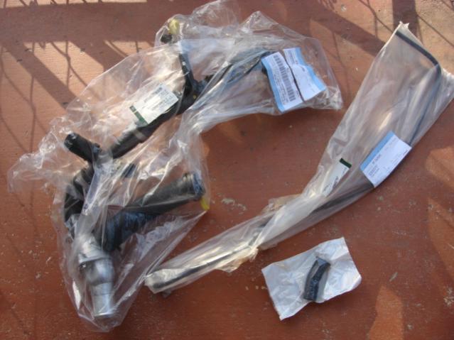

I just got some more parts day, radiator hose, brake vacuum tube and PCV hose that connects to the intake.
I ask the deal about the clips they cost $10 each and I had to order them.
