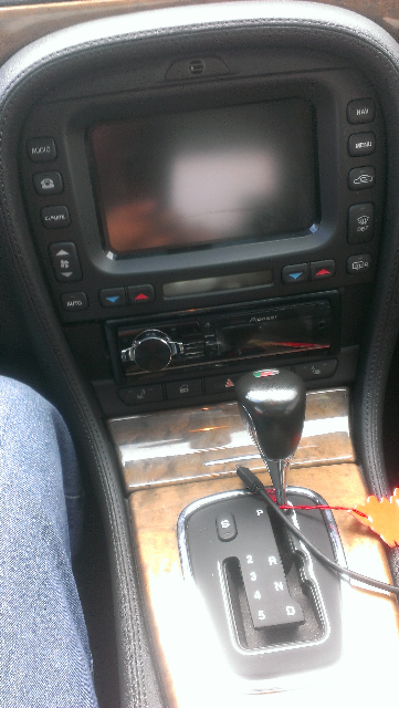

How can I install bluetooth for stream music in my Jaguar Stype 2008 ?-forumrunner_20131110_235424.png
Click image for larger version
I did change CD player and amp sounds good and got sd card slot and BT on mine not a lot of work.
