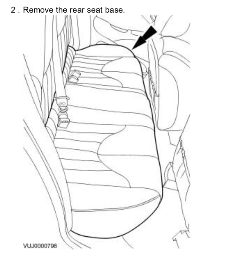

I need to replace the rear centre seat belt buckle, and need to remove the rear seat base, but I don't know how? The manual I have is no help at all, saying simple "remove the rear seat base", with a diagram with one arrow pointing at the seat! Couldn't be less helpful :-(
Any advice?

Excellent! Thank you. For whatever reason, that post didn't show up in my search. Turns out the buckle was not faulty, but someone had spilt some grainy looking dirt down the back seat, and some had found it's way into the buckle mechanism and was jamming it and not locking. Turned it upside down and gave it a few taps to remove all the crap, and it's working perfectly again.
