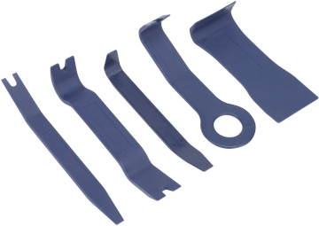

I'm about to do this meself - my front chrome inserts are a bit scuffed now from sheer mileage, especially the left-hand one. I bought this Sealey trim-tool set a couple of years ago when I had to remove the instrument binnacle from Mrs. Goose's Citroen - don't ask!
I got new inserts, as well as the little reflectors just behind them, from British Parts last week and I'll change the whole lot out. Wish me luck!

Hmm. I've had little success with this. I can't see how to free those little clips behind the trims without dropping out the actual bumper, so this I will do shortly, unless anyone can fill me in on some little tricks I may be missing?

I got that exact same set of nylon pry tools at Harbor Freight for $6. They really help prevent marking the paint up.

Done! I can confirm that the General's nose is now both pimpin' and blingin'. In a very tasteful way, of course. ;o)
