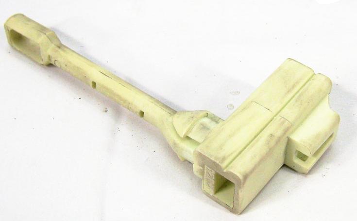

There are 4 or 5 interior temperature sensors that could be giving you problems. Remove and clean the temperature sensor behind the small grill located directly above where you put the ignition key. I have found this gets a layer of filth built up and can cause all kinds of strange stuff. I replaced this on my wife’s 2003 Lincoln LS after replacing the DCCV and thermostat and coolant. It fixed my heating/cooling problems.
Be aware your lack of heat can also point to the AUX coolant pump failing. Try this before condemning the pump. With the car stationary rev the engine to 2000 rpm and hold it there. Adjust the heat settings to max. If you get heat then let the car idle and see if the heat dies out or stops all the way. If it does then change the pump. If no change then I think you have different problems.
One last thing have you checked or changed your cabin filter?? I have seen these nearly blocked solid and can cause weird temperature problems.
The interior temperature sensors look to be all the same. The Lincoln and Jaguar parts look to be identical too! I have attached a picture of one.

Tried the 2k rpm test no change. I guess I'm still too new to view attachments can you embed the images? When I took the cover off that sensor above the ignition it looks like a socket no sensor that i could tell.

Upon looking closer I saw the sensor and it's pretty clean. Where are the other sensors in the cabin?

First even if the sensor looks clean. Take it out and spray the bulb end with carb cleaner. There is a dirty film you just can't see it. If you are getting that deep into your car buy the JTIS off EBay. They are only about $10 and it will be the best $10 you will ever spend!!!
I can't embed images because they have to be hosted somewhere on the web. Attached is much better because as time goes by people change their web host and all the embedded pictures disappear but the attached images are always there.
