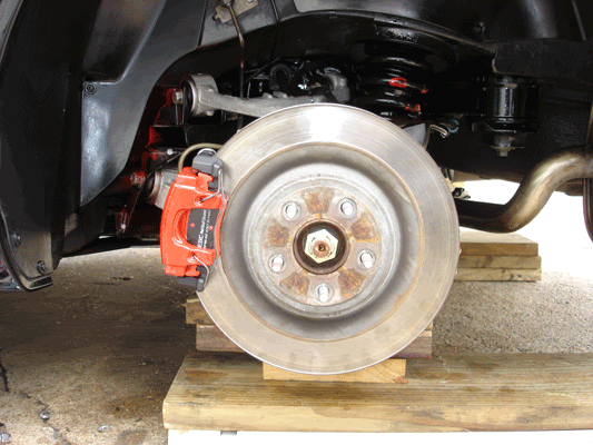

I purchase a set of EBC Redstuff , the end of last year I put on the rear.
And I found out how to get the calibers back in “without any special tools” I did this because there are no tools out there.
This has been a learning experience.
Now my Yellow and Red Lights are coming on saying “NO EMERGENCY BREAKS” . I think when I put the front ones
on “I have the old one’s on now, NO I AMNOT Driving the Car”. I will bleed the brakes and see if that era message goes away.

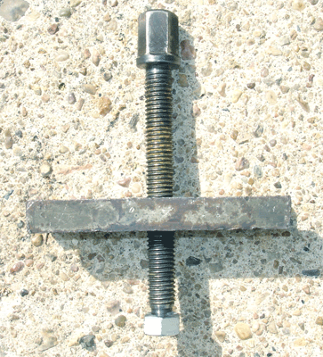

And a C-CLAMP would not work in my case [sm=badidea.gif]. . .what did work alot better was a crankshaft pulley.
Worked like a charm.

FRONT BRAKES: NEW JAGUAR PADS & TURNED THE ROTORS. THE ORIGINAL PADS WHERE DOWN
TO ABOUT 80% "20% PAD LEFT"
REAR BRAKES: NEW EBC RED STUFFS & DID NOT TURN THE ROTORS . THERE IS A SMALL LIP
ON THE OUTER SECTION OF THE ROTORS. BUT THE ORIGINAL PADS WHERE ONLY WORNABOUT
30% "70% PAD LEFT".

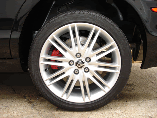

PS: NO ONE MENTIONED MY RED PAINT JOB ON MY PAD HOLDERS [sm=bounceybounce.gif]

I loved it ............. it looks awesome
