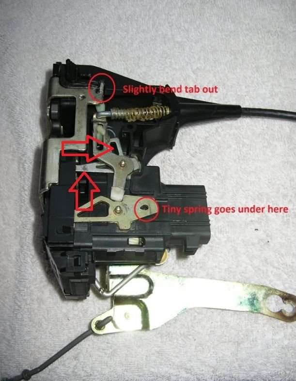

More thoughts:
Look at this FAQ (by Joycesjag) for an idea of what the latch looks like. This isn't your problem exactly, as it's a repair of the electric lock actuator, but the article has some good pics of the latch assembly:
https://www.jaguarforums.com/forum/s...ics-faq-65657/
Obviously you can't remove the latch, as there are three bolts on the aft edge of the door. But look at this picture, stolen from the FAQ and lightly edited:
At the top, you can see where the cable comes from the interior handle. At the bottom, the linkage (on the opposite side of the latch) comes from the exterior handle. Either input appear to rotate the bellcrank in the middle, which rotates another piece where I've added the two arrows. I think that is the piece that needs to rotate for the latch to release. If you can snake your hand in there, lift up where the vertical arrow is pointing. If your hand won't fit, you might be able to fabricate a hook to grab the slot where the horizontal arrow is pointing. Pull forward there and it would be the same as lifting up where the vertical arrow is pointing.

I agree now that the hinge idea is a no no as the latch will stll hold fast anyway. The picture will certainly help now I know what to manipulate and the idea regarding the cushion and seat-squab may just work.

Just a kwik hello and thanks for the pic you sent. It gave me an idea. I made a skinny aluminium tool the size of a hacksaw blade and cut a 3mm slot on the end, inserted it down past the rubber of the quarter glass seal and heard a click, Hey presto!! the child lock was engaged and as the outside handle was busted only the inside handle could open the door but not with the child lock engaged.
It must have been engaged for years judging by the crap that was between the door and the jambs.
Thanks again for the inspiration Karl.
