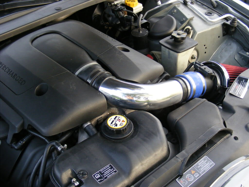

...I too would like to get a 3" Aluminum elbow that replaces that Plastic intake tubing thats originally on there.
Anyone find a replacement for the mid section intake tubing thats already made to fit the STR? Exactly like the pic I attached minus the Cone filter, I want to stick it with the OEM air box.

I see a HUGE problem with changing out the OE elbow although it's really nice to get rid of silencer baffles. A metal elbow does introduce heat soak. Since it's essentially over the blower. Without some sort of coating all you would do is make the intake louder but no true gains I can forsee losses actually. That's the same problem the Mina gallery intake suffers from. I'm looking into some sort. HPC coating that might help out. We are pretty much on our own for performance stuff so we need to do it right

I would find it hard to believe that the air will heat up a significant amount as it passes through it. Even if it does, it wouldn't be much and the increased flow would make up for it.

Possibly, I don't have any solid numbers in hand but I know logically speaking it won't help out for heat soak. It could also end up like the Mina gallery intake. I'd like to get my hands on an OE tube to see if I can make a fiberglass one or carbon fiber one

I am tempted to get one of the universal ones from Autozone and try. I will take some air temps also.

Yea my local speed shop and I have been fabbing a couple prototypes including one to draw air from the lower front air dam. Or possibly putting the filter in the bumper and HPC coating the whole thing in the inside to keep the temps ambient or as close as possible. Right now with the plastic tube I've been reading about 5 degrees above ambient driving for 20 min. Letting car idle for about ten min. I see about 140 degrees when ambient is about 90 degrees go out for a 20 min drive and I still see 100+ degree temps with 90 degree OAT. That's why I'm so concerned with the heat soak issue. I have some data logs of you want to take a peek.
