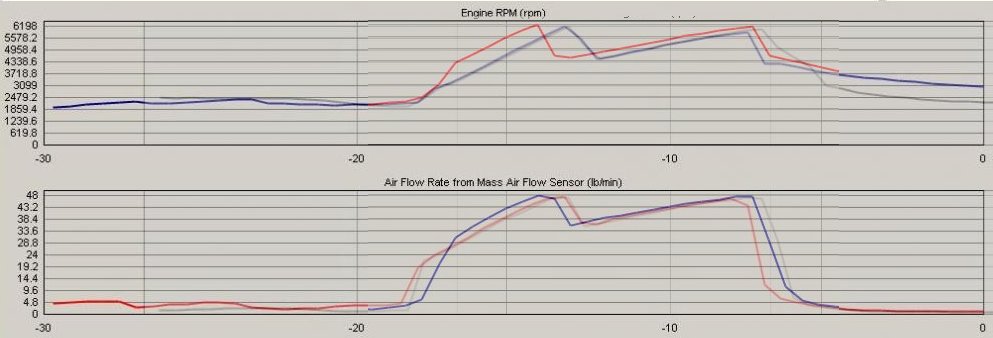

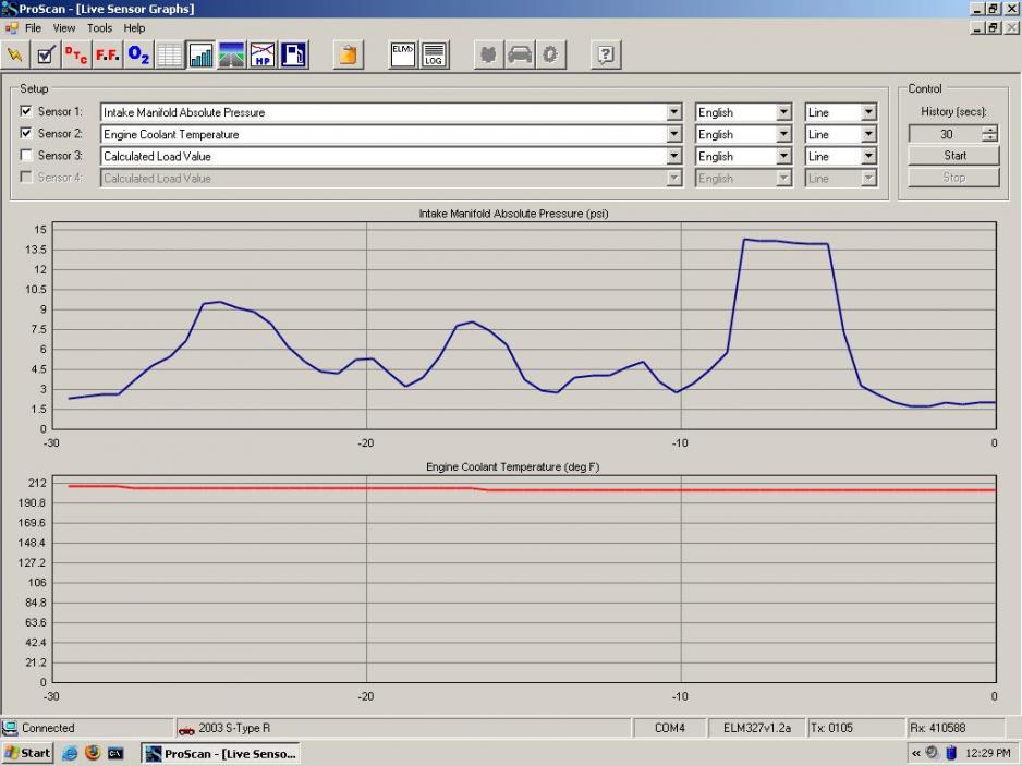

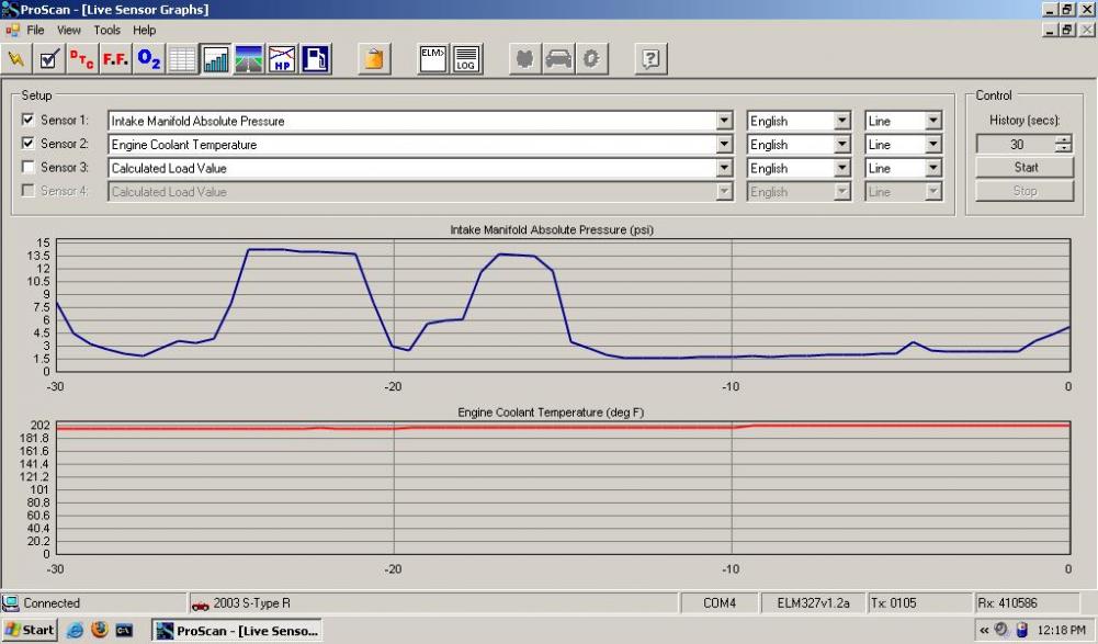

After struggling with an underpowered air compressor, a lot of grinding, and some spilled coolant, the new 2.5lb pulley is on along with the t-stat.
And here are the results:
-1st pic is flow comparison with the new pulley,
new pulley colors- rpm=red, MAF=blue
stock pulley rpm=blue, MAF=red
stock intake gray
-2nd pic is stock pulley/t-stat intake manifold pressure an coolant temp
-3rd pic is new pulley and lower temp t-stat manifold pressure and coolant temp
I'm very happy with the results - the cars feels so0o0 much stronger throughout the rpm range. In the 1st pic, you can see how much quicker it is to hit redline. The thermostat lowered the coolant temp almost exactly as much advertised. Intake manifold pressure stayed pretty much the same even after the pulley. This makes me wonder where the sensor is located - apparently it's not a good indication of the actual s/c boost.

Awesome blaksplash! Thanks for posting the results. Now I am second guessing my readings for manifold pressure...I also indicated around 13.5psi of pressure with 14psi spikes here and there. Anyways, my complaint to the Mina Gallery about my apparently false underboosting situation allowed me to obtain a large discount on their exhaust!

That is a hell of a write-up and I'm an English major, that was a very good observation on the mina gallery intake. One of the other members said that it is a hot air intake and it would make the car slower, which you also observed. Unfortunetly I spent the 135 bucks on the mina gallery intake, but decided not to put it on. I just put in a k&n filter which gave it a little kick and I already had a 1.5 pulley put on because I needed to address vacuum leaks underneath the supercharger. My STR feels a little bit zestier, so im looking forward to future posts.

I wouldnt go as far to say the conical filter makes the car slower, looking at his stats at full throttle the air temp increase was only 15 degrees but the airflow increase was 6.5lbs. I dont think the temp increase is enough to offset the gain from the increase in air to the supercharger.
Don't forget that reading was taken when i used the mina MAF sensor housing, which is smaller than stock. The sensor calibration is for the stock sized tube. As Andre pointed out prior, it thought more air was flowing than actual. I would like to see the reported flow with a conical filter and the stock MAF housing (cut off the stock filter box), but i'm not going to hack mine up. Just replacing the filter and mid section tube gave a true 4.5lb/min.
