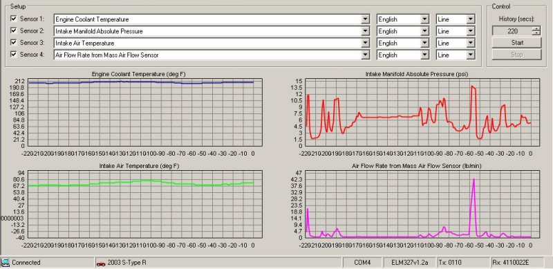

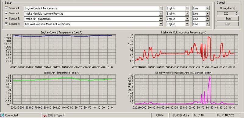

I don't have any pictures.. yet. It looks very similar to this except the stock filter box instead of and open air conical filter. I will try to snap a pic soon.
Well last night i ended putting xp back on my laptop. I installed the obdII software and pulled the code- P1111 Intake Air Temperature Sensor Circuit Intermittent High Voltage. I've seen where just cleaning your MAF sensor will sometimes cause this to fire. I'll monitor to see if it comes back. I cleared the code and commenced doing a series of tests using the obdII scanner...
The test consisted of
(a) cruising for a couple miles in second gear at around 35-40mph
(b) stopping and idling for about 40 seconds
(c) then cruising in 2nd for about 45 seconds at 30mph
(d) hammering 2nd gear from 30mph till it hit the rev limiter.
The engine was properly warmed prior to the begging of each test
Ambient air temp during all test: 61deg F
here are the results...
test 1: completely stock intake. stock mid pipe, stock filter box, stock panel filter
(a) intake air temp: ~68 deg F
(b)
intake air temp: ~79 deg F
(c) intake air temp: ~71 def F
(d) intake air temp: ~68 deg F, air flow rate from MAF sensor ~43.5 lb/min
test 2: 3" aluminum mid pipe and open air conical k&n filter
(a) intake air temp: ~74 deg F
(b)
intake air temp: ~149 deg F
(c) intake air temp: ~111 def F
(d) intake air temp: ~83 deg F, air flow rate from MAF sensor ~50 lb/min
test 3: 3" aluminum mid pipe and stock filter box, k&n panel filter
(a) intake air temp: ~67 deg F
(b)
intake air temp: ~78 deg F
(d) intake air temp: ~67 deg F, air flow rate from MAF sensor ~48 lb/min
I would imagine that if the 3" pipe was replaced with a 3.5" pipe for test 2 & 3, the results would be even better. I saved screenshots of the tests.
As a reference,
(b) is ~170-110
(d) is roughly at -60.
P.S. am i really hitting around 14psi of boost?
Attached Thumbnails Intake experimenting-test1_stock.jpg   Intake experimenting-test2_openfilterandpipe.jpg   Intake experimenting-test3_pipekn.jpg

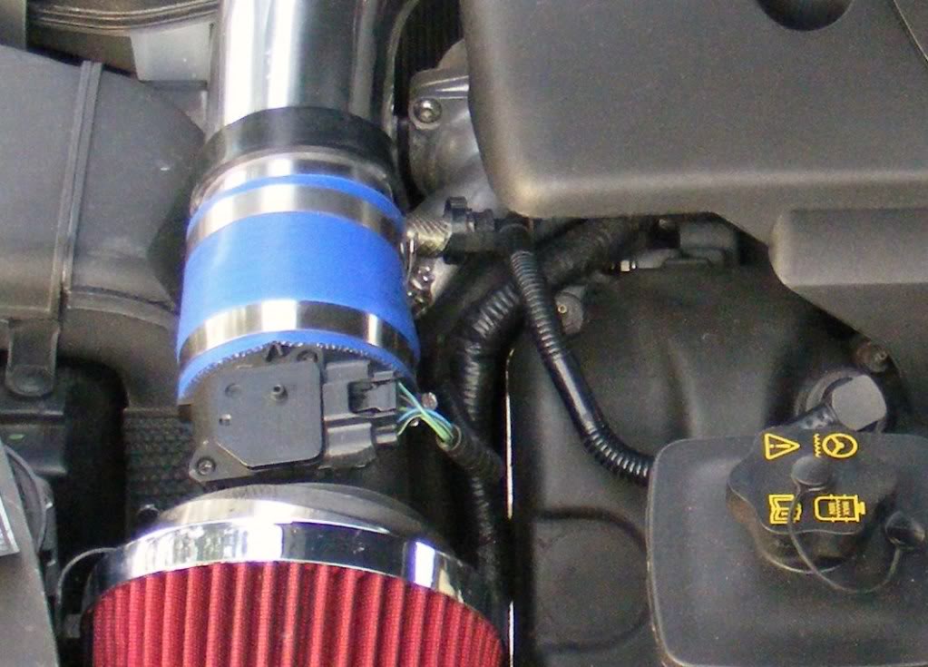

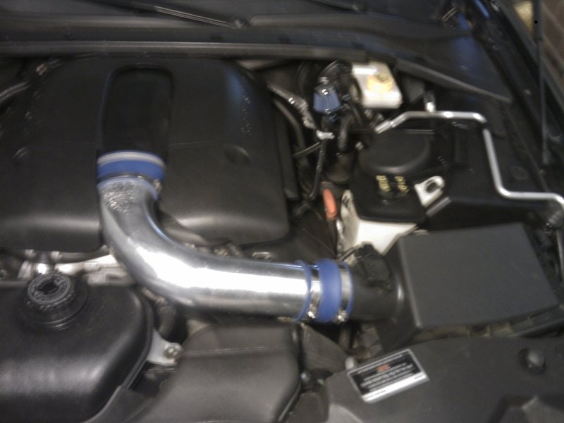

attached is a quick camera phone pic of the intake

Thanks Demien. This is the same kit i got off ebay. Right now i'm only using parts from that kit except for the small filter on the breather hose (autozone). I used 1 of the 90 deg elbow pipes, 2 silicon couplers, and 3 of the circle hose clamps. I reused the stock circle clamp that went around the oval part between the two charge coolers because the ones that came with the kit weren't quite big enough. + a k&n panel filter in the filter box. I'm still trying to decide what the best would be to put the breather hose on the new pipe.
and so far no warning lights... but i will definitely let you know if it returns

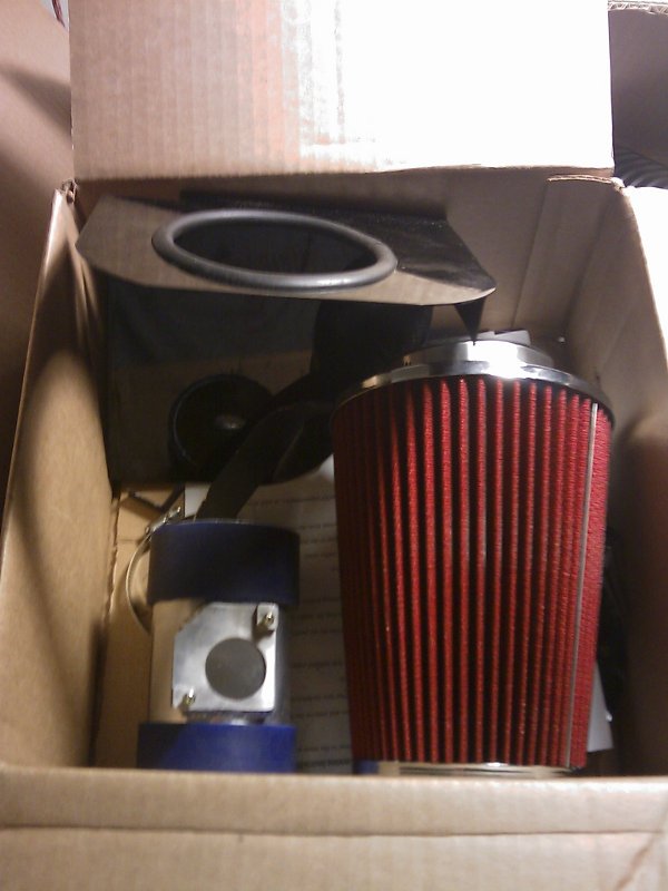

for those of you who would like to see the stock tube that was replaced, i've attached pic of it - notice all 6 silencing tubes and many cavities. also attached is a pic of the mina intake kit - the aluminum tube is the MAF sensor tube, the heat shield is in there as well.

unfortunately, the mina kit uses the factory tube
While i work on getting the breather hose on my aluminum pipe, i put the stock tube back on. I realized that I never did a run with the stock filter box and stock pipe with the k&n panel filter.
So, here is a graph of the stock box/pipe with the k&n filter, and also another graph of the stock box with k&n filter and aluminum pipe. This time there is a bit more detail... but i should have graphed RPM as well. Just by adding the k&n filter allowed it to hit a much higher flow than the stock panel filter, which hit ~43.5 in the other test... or maybe my paper filter was just that dirty?
Low-mid range has much better airflow, and max flow at the top is sustained longer.
Attached Thumbnails Intake experimenting-stockpipe-kn.jpg   Intake experimenting-aluminumtube-kn.jpg

Very interesting thread. What software and reader do you use to pull out these numbers, blaksplash? It would definitely be helpful for me, and I assume many other people, if we could know what you are using so that we can all monitor our numbers.
I wonder if my car will read that it is taking in a little more air as I have a pulley. Your car has the factory pulley correct?

Originally Posted by avos
"and today it threw some codes- p0171 & p0174. I'll try cleaning the MAF sensor and see if that helps. Also, anyone got a good idea how to plumb the breather hose to the aluminum tube? "
If you haven't connected the tube, the engine will suck false air in, so most likely the case of the P0171/P0174, which are lean codes.
You must connect this breather tube to the intake; otherwise you could get an imbalance in engine over/under pressure. Ask an aluminum welder to fit a similar connection fitting to weld to your intake tube; any professional welder can do this for a fair price. Then connect the original tube to that.
Andre.
Andre is correct. I purchased my intake tube from a shop that welded the connection for the breather tube. No codes after install.
