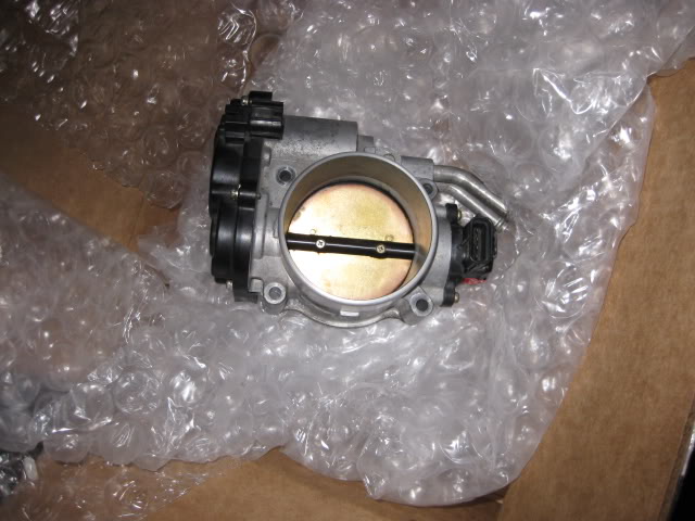

Got the TB back from UPS today. It only took about a week for the whole process, shipping both ways and the rebuild itself. It will be reinstalled the middle of the week.
