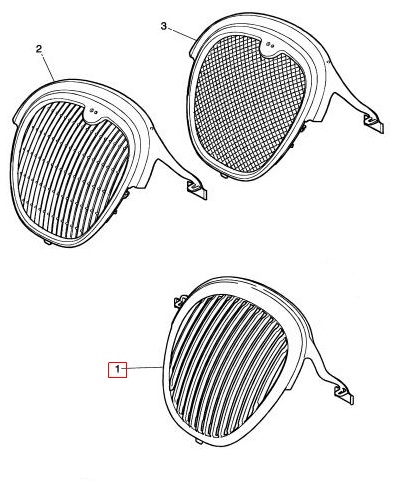

The Parts Manual illustration of the two grille patterns which have a growler badge appear to show two mounting holes in the grille:
If the fixing lugs on the growler badge aren't threaded, it will probably be secured with star washers.

Awesome! That is exactly what I was looking for! I couldn't tell if it was clipped on or fastened with the star / locking washers... I know the replacement is threaded so I ay have to modify a bit but the holes in the diagram look correct to my replacement growler.

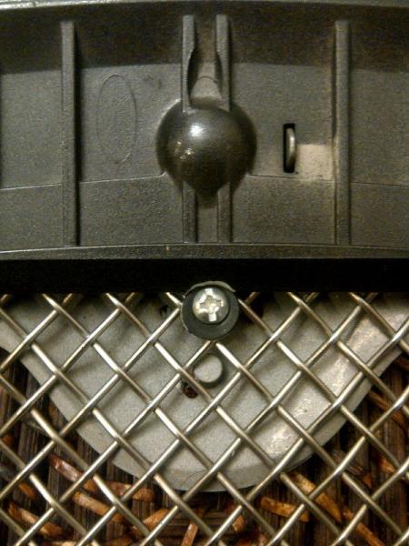

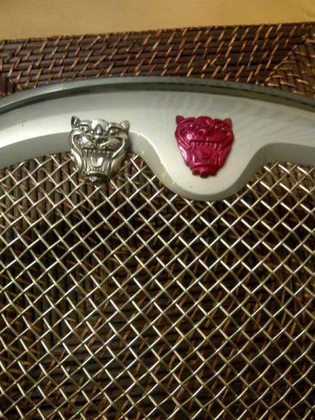

I got my "Carmine Red" Growler today in the mail direct form the UK. I have to say this one is much nicer than the stock plastic one. This is a solid metal piece and really sets off the nose of the old girl.
I have the red growler wheel caps on my XF Cygnus wheels they actually look better on our old S-Type than they do on the XF IMHO, but hey I am an STR fan so I am biased.
Thought you all might enjoy a couple of shots of the install.
For anyone interested in upgrading their grille growler badge you can find them on eBay for around $10 us in Red, Balck, Chrome, Gold etc etc. They are supposed to be for the X Type but with a drill, machine screw and a flat washer its an easy fit!
Enjoy!
