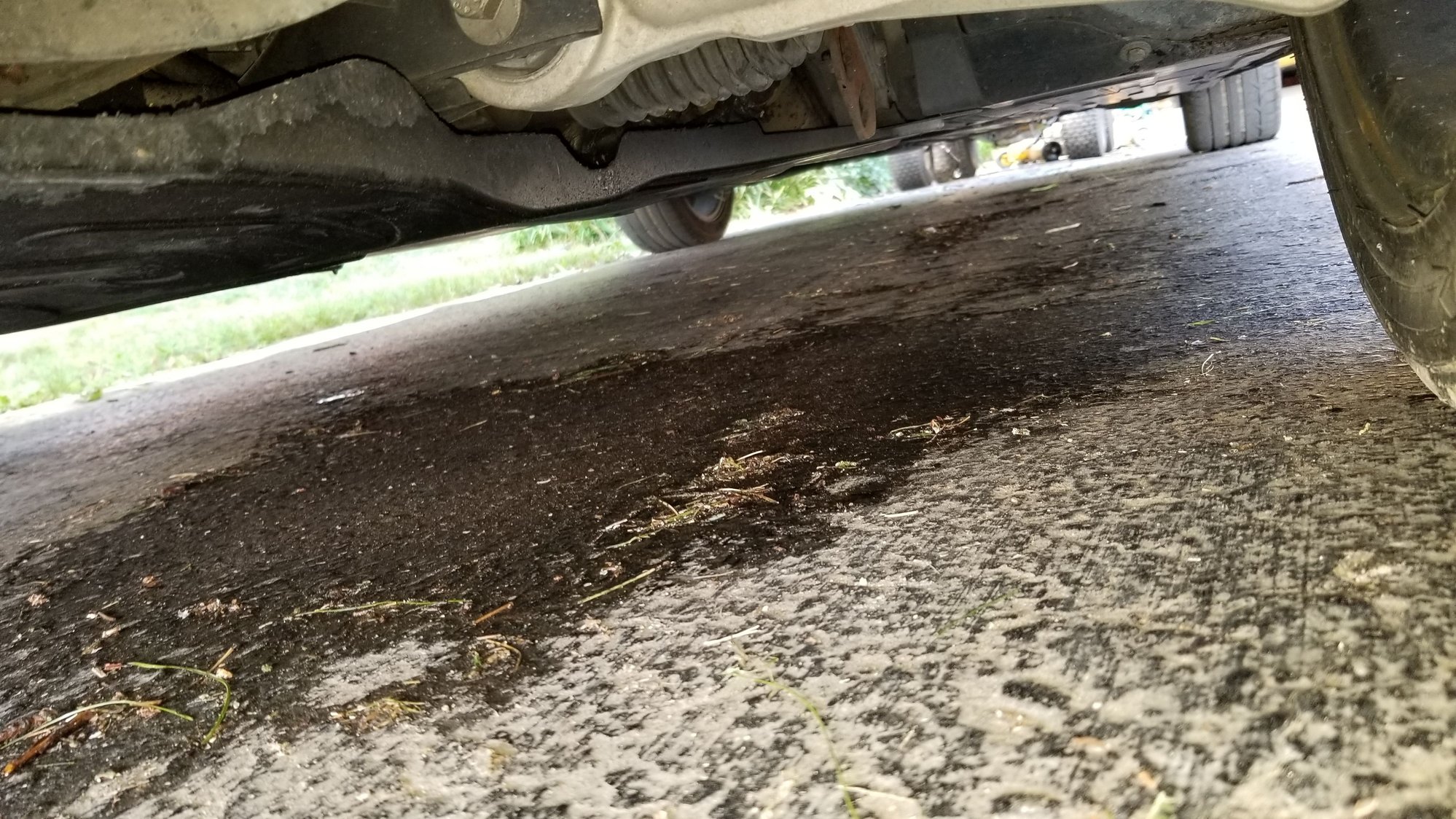

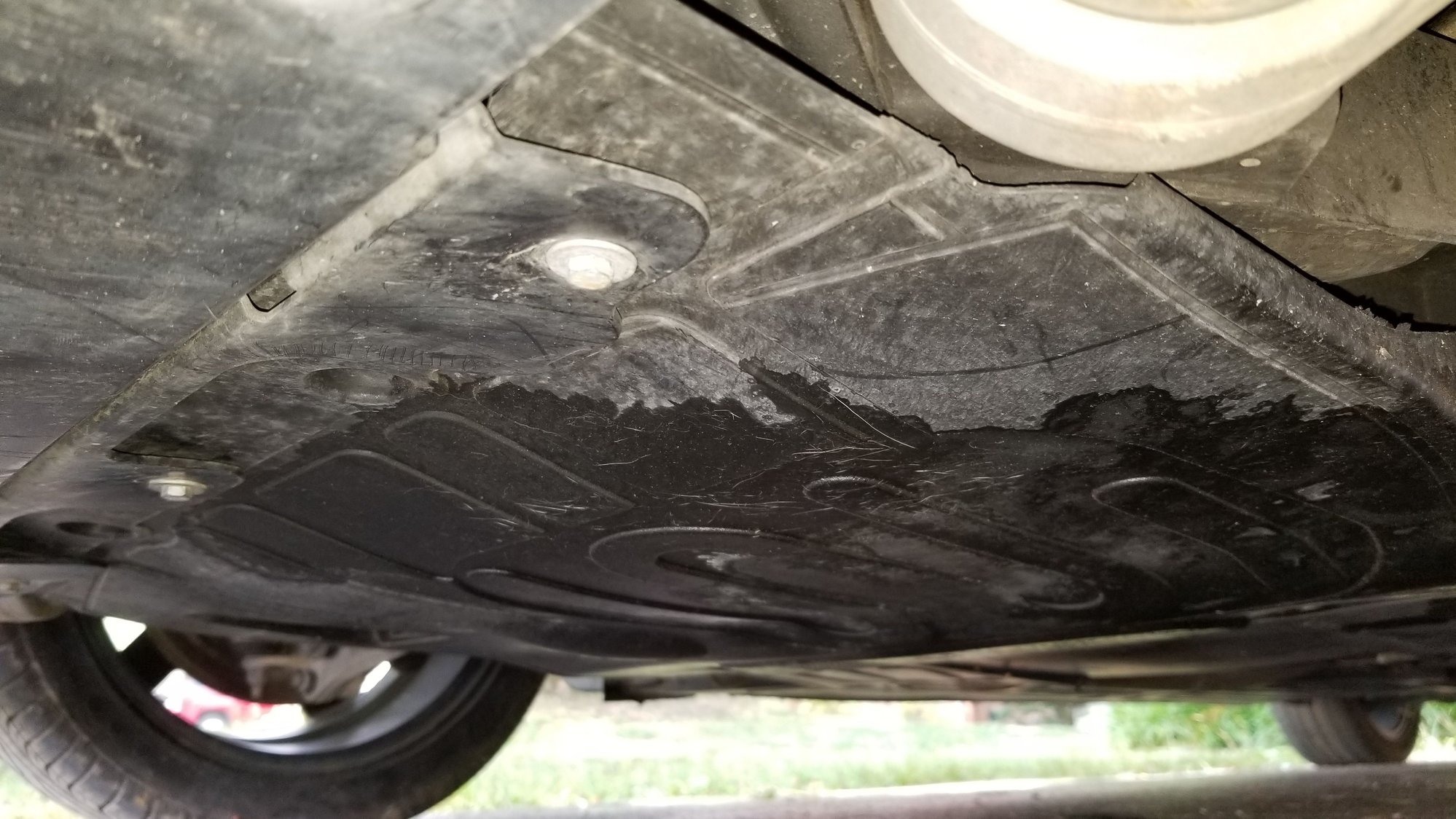

Here are a couple pictures. We did just get rain here so I am not sure all of what is seen on the ground is antifreeze but some of it is and there wasn't any antifreeze when I parked the car yesterday. This seems to happen once the car is parked for some strange reason?

Definitely remove the big panel underneath and the smaller one directly under the radiator...fill the cooling system as best you can without starting the engine...the colder the better for safety....especially if you are on jackstands....use a pump up style pressure tester and start looking....good luck

To pile on the other comments, use a pressure tester and look for a leak that way. This is far more comprehensive that just doing a visual look-see with the engine at idle. Under those conditions, not much pressure builds up and smaller leaks may not be present. Use a pressure tester and pump up the system to the rated capacity on the cap. Make sure the cooling system can hold pressure for at least 15 minutes or so. Pressure test the cap, too.
These vehicles are very sensitive to cooling system pressure. If a leak is present, the pressure never builds up to the required level. Some leaks, especially high on the engine, will mostly vent air and not much liquid, so leakage is not always obvious. Coolant flow through the various passages is affected when pressure is low, even if the quantity is okay. Overheating, false indication, and erratic heater operation can result. So get thee a pressure tester and make sure the system is liquid tight.

@Kane Emery, as Karl suggested in post 11 above, use a pressure tester after a cold soak, preferably overnight, to determine the source of the leak. Pump the pressure tester to 1 bar and see if it drops after ten minutes. If it does, find the source of the leak and correct it.
If the water outlet has not been replaced, it should be replaced as an assembly as it can only endure a finite number of cold to hot to cold cycles before failing. The hose from behind the water pump under the inlet manifold to the throttle body is also prone to failure and should be replaced or it can leave you stranded.
