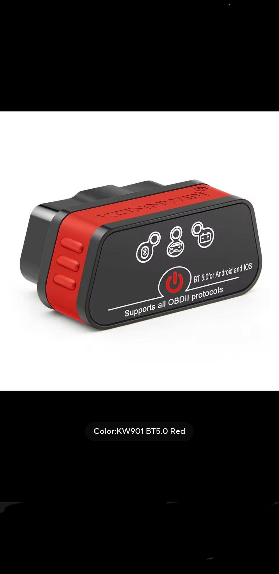

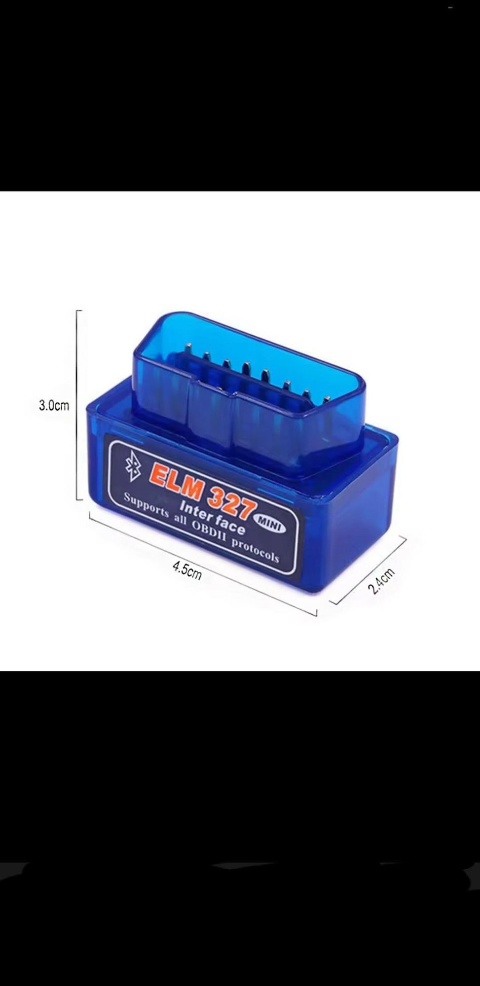

Hi I have 3 ELM327
None of them worked on my str or the wifes 03 4.2 N/A
Two of them packed away in a container
All of them are Bluetooth for Android
This is what I have
1st one BT V2.1
2nd one BT 5.0
​​​3rd one BT 3.0
THANKING YOU
DARROL

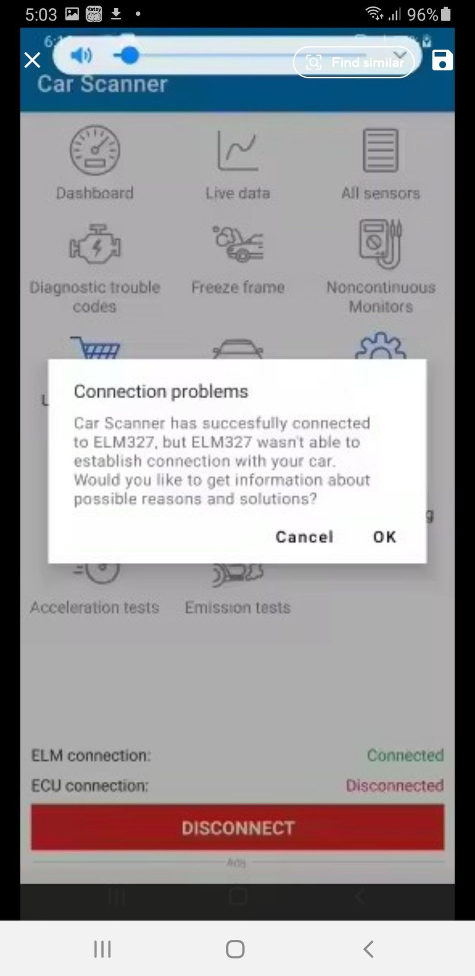

Thank but this is all I get

hi jag v8
Thanks for that
I tried different apps no luck
So contacted the seller they informed me it will not work on the s type
so I took the wifes 4.2 s type to the local auto parts store
and we tried 3 different elm327 ,s
Not one would connect to the wifes car
Thanking you
Darrol

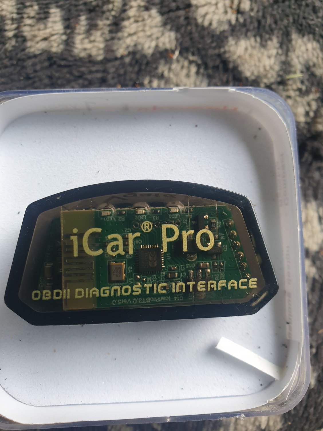

I have one similar to your first picture and use the Torque Pro app daily in my XK8 (use it to display Coolant temp, short/long term fuel trims and a few other parameters) I've also used it to scan a coworkers S-Type and XF. I will get the readers specifics and post tomorrow
