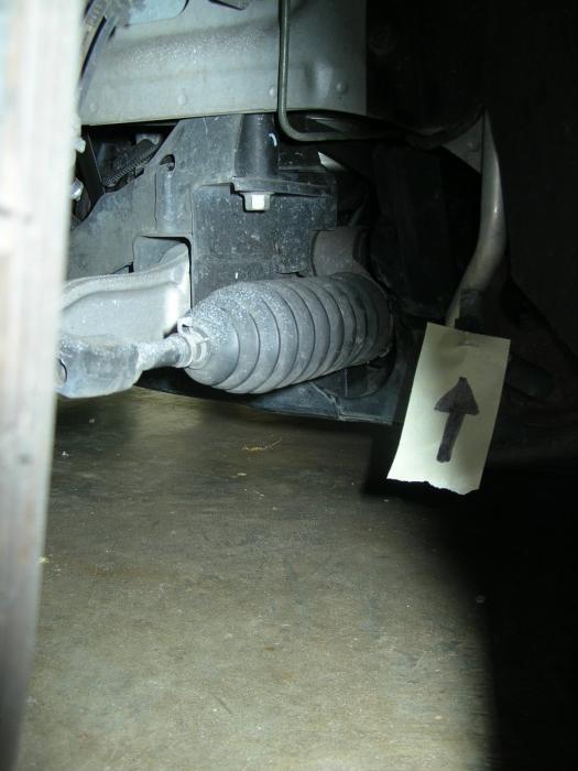

Hey if anyone could give me some help with this i would greatly GREATLY appreciate it. I have a 2006 Jaguar S-Type R, I am trying to add refrigerant but I am having difficulty locating the low side to add. Could anyone give me an idea?

It should be on the drive side, under the driver side front wheel to the back of the fender trun your wheel to the right so you have more room. That is were it on my 2003 v6. should be the same.

https://www.jaguarforums.com/forum/s...ics-faq-55219/
or before the high tech:
drivers side front wheel.
